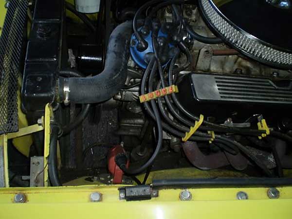

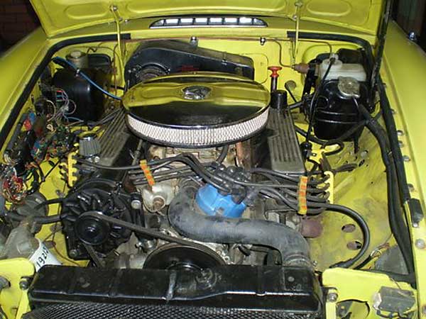

Engine: Rover 3.5 V8

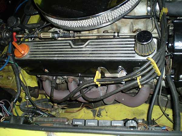

Engine: 1978 Rover 3.5L from a Rover SD1. Offenhauser intake manifold, Holley 4-bbl 465cfm carburetor, remote oil filter.
Transmission: 1978 Borg-Warner BW65 3-speed automatic transmission (from the Rover SD1 sedan). Ford Escort gear selector. Triumph transmission cooler. Land Rover driveshaft, with rear end modified to mate to Ford axle.
Cooling: MGB-V8 radiator. Twin electric fans (with motors from Suzuki H4).
Exhaust: block hugger headers.

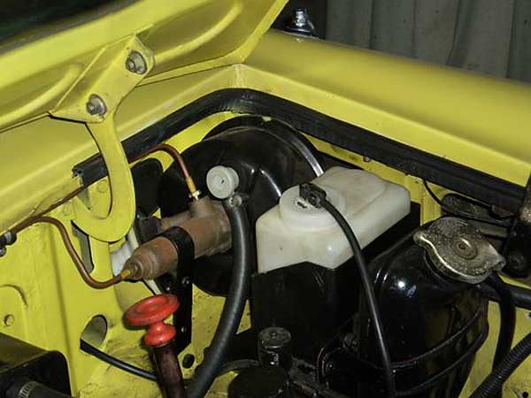

Brakes: MGB V8 front rotors. Front calipers made from Triumph inners and MGB outers. (Servo and backplate are standard.)

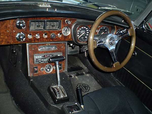

Instruments: Rover SD1 speedo and tachometer modified to fit in original MGB cases. (This meant that a Rover speedometer drive was also used.)

Comments: if I did it again, I'd use RV8 headers.
MGB V8 extended core radiator
remote power brake servo
MGB woodgrain dashboard

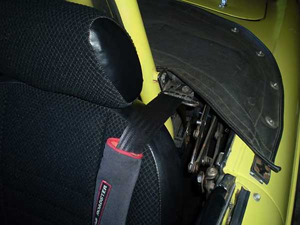

nifty roll hoop and seatbelt mounting
