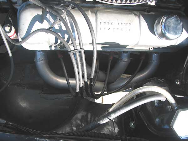

Exhaust: Through-the-inner-fender 4-into-1 headers (home-made with parts from "Headers by Ed"). Two small glass-pack mufflers.

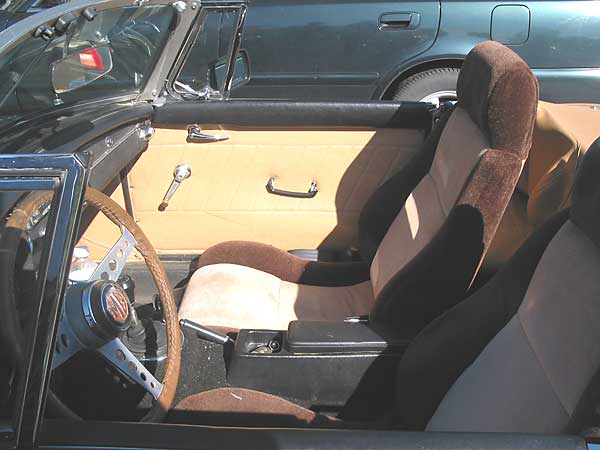

Interior: Pontiac Fiero seats with headrest speakers and custom upholstery.

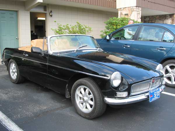

Al Wulf and his 1967 MGB V8
Al Wulf and his long distance touring car.
driver-side exhaust header
Al fabricated his own through-the-fender headers.

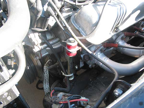

supplemental torque rod limits rotation of the engine on its mounts.
A supplemental torque rod limits rotation of the engine on its mounts.

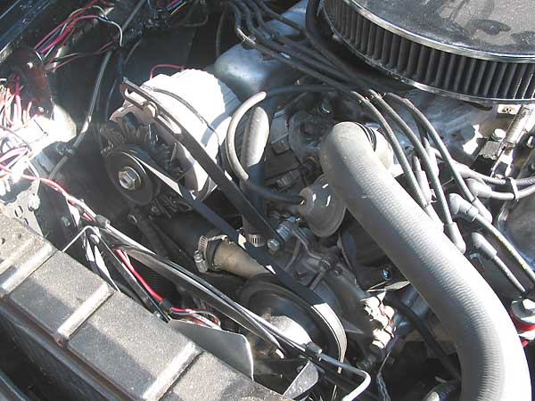

Delco-Remy alternator
A reliable Delco-Remy alternator.

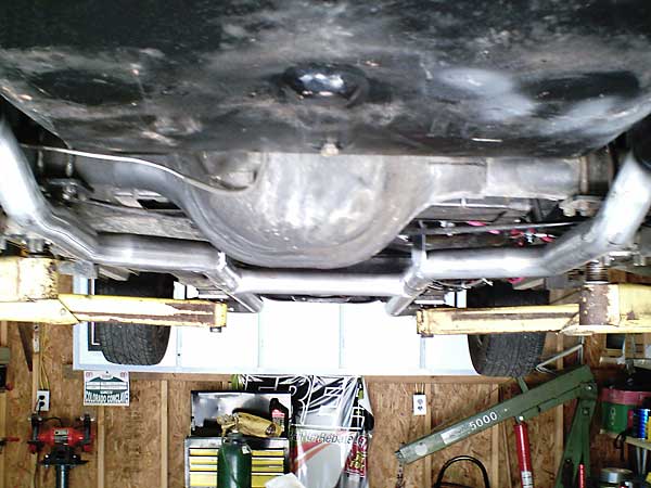

New Stainless Steel Dual Exhaust With Crossover
Stainless steel dual-exhaust with crossover pipe.

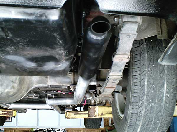

Glass-pack mufflers on either side of a centered fuel tank
Glass-pack mufflers on either side of a centered fuel tank.
Pontiac Fiero Seats
Pontiac Fiero seats (re-upholstered to suit the MGB).

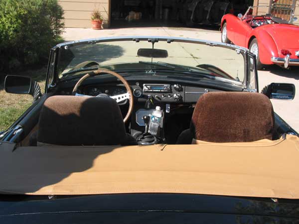

Daytime/Nighttime Mirror
Notice the in-dash CD player and the daytime/nightime mirror.
