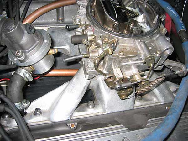

Edelbrock Performer 1404
The 1404 is probably the easiest four barrel carburetor to tune and is designed to have a good power and fuel-efficiency. But, contrary to appearances, maximum fuel efficiency is really subject to the intake manifold choice. Before choosing a dual-plane, for example, it's necessary to have a look at your camshaft characteristics. Most intake manifolds are made for maximum efficiency under 4500 RPM. With these ones, forget seeing 5500 RPM and above!
The guy who needs power everywhere must get a single-plane intake. For me, the best from idle to 7000 RPM is the Huffaker (from Real Steel: 240 UK Pounds, see the picture), but 1" higher. And probably the single-plane Harcourt too, from D & D. The Edelbrock works very well with a Huffaker.

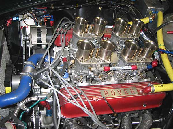

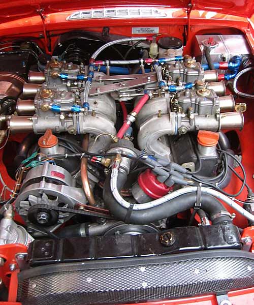

4 X Weber 40/45 DCOE
Here the horses are breaking into a gallop! The cheapest on E-bay is the 40DCOE, but the 45DCOE has the best potential with big-bore engines. A set of 36mm venturis for a fast road car, or a set of 38mm ones if you are going to rally. Properly jetted, they will give a lot of torque, but not the maximum BHP possible. As for the sound, the best, no doubt!

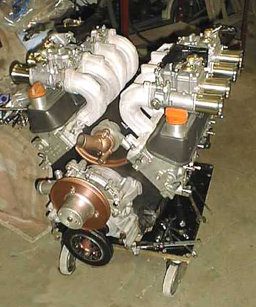

4 X Weber 40/45 DCOE with swan neck inlets
Matthew Cooper from Eurocarbs Ltd (www.Dellorto.com) can provide the swan neck inlets shown above.

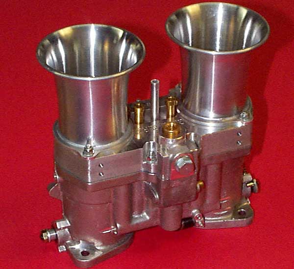

4 X IDF
4 X IDF
More power, a little bit less torque. The 48IDF works very well on big bore engines.

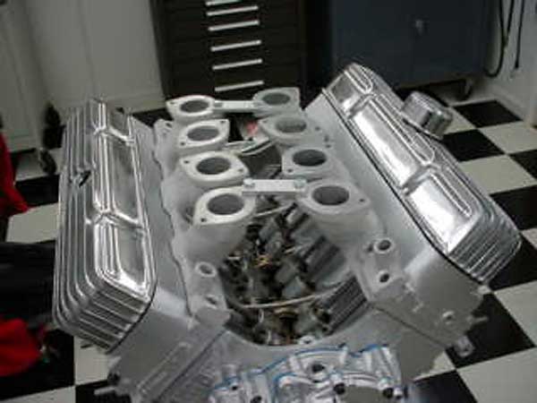

Weber IDF
These are the shortest manifolds, and are not easy to find. Equipped with short rams, they can fit under an MGC Bonnet. Dan LaGrou has this very good one from Harcourt.

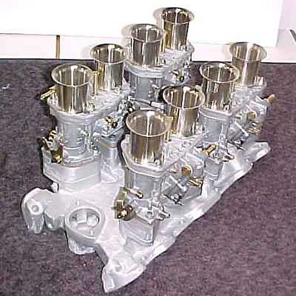

water-heated intake manifold
Mangoletsi in the UK makes a stock style water-heated intake manifold. Very nice. Pierce Manifold claims about 20 bhp more than fuel injection. (K817 $306 + MM4471 - $1,626)
Available from Europa spares, too, about 500 UK Pounds (www.europaspares.com, item 4471A). Be careful because this intake (as is true with the stock one) doesn't like the hard planed cylinder heads. Lowering the heads, raises the compression, and "moves" the ports and the bolt holes down. On mid tune engines, go to the 40IDF.
