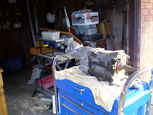

In Australia, a popular way to convert to a 5-speed transmission is to use an aluminum-case gearbox from a Toyota Supra. These are used behind a broad variety of engines including the Rover V8's used in MGB V8 conversions. The four models of Toyota Supra box are lightweight, compact and inexpensive. The transmission face-to-shifter dimension can be found in four different variations: 18", 19", 20.5", and 21", allowing tailoriing of the installation to use the stock tranny-tunnel shifter hole. The Supra gearbox is plenty strong for service behind a V8 and it is very smooth shifting.

    Gearbox weight: 35kg
    Input shaft: 21 splines by 29mm
    Gearbox length: 22"
    Tailshaft splines: 21
    Oil capacity: 2.5L
