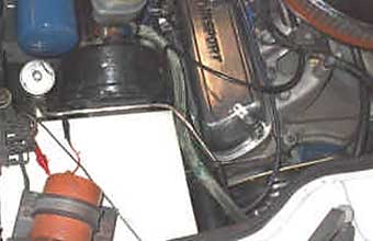

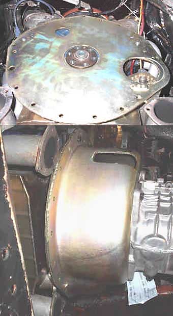

First thing was to make more room for the bell-housing. I installed a new flywheel pressure plate and clutch, pilot bearing, all Ford Motorsport parts. I used a Lakewood blow-proof bell-housing. Note that it is a bit larger than a stock T5 bell-housing.

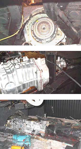

Bell housing and transmission installed. Note that I did not have a throw-out fork installed. The use of a pneumatic throw-out bearing saves space and is easier to install.
The Tremec rear mount was in a different location than the C4, but I believe it is the same as for the T5. I made a new mounting plate and moved it back 2 inches. It is also important to make this so it can be removed.

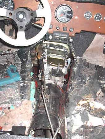

The transmission is now in position. I installed the transmission from the top because the car was sitting on a trailer and, of course, all the interior had to be removed. This was the lesser of the two options I had. The other was to pull out the engine. Note that the standard Tremec shifter location is in the rear. This is back just a bit too far for my preference, so I elected to spend a additional $300 to get the mid shifter kit. I believe most people may be OK with the rear, using a bent forward shifter.

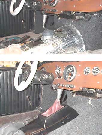

Here is a better view of the shifter location. The drive shaft did not have to be touched, as it was the same length and setup as the C4 installation.
This is what it looks like with the center shift kit installed. The Tremec transmission is a bit taller than the C4 I had installed before, so I cut the top of the tunnel out to allow room. The shifter arm was heated and bent back about 3 inches for fine adjustment.
The finished installation. To cover the hole made by the larger transmission. I used a center console from a 1985 Honda, which has worked out quite well.

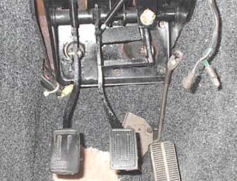

The pedal set up was on the small side for foot space. Because of the larger bell housing, everything was shifted to the left about 6 inches. Note: the brake pedal is where the clutch pedal was and the clutch is moved over and attached directly to clutch actuation lever.
