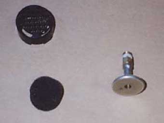

I saw Bernie at the Ohio MG meet in Columbus. He had checked around before the meet and found that the Rover V8 used a different breather system. He used this system on his trip out to the Columbus meet and it worked! Well, then I went to Land Rover of Solon Ohio and found a parts man who knew what I was talking about. He told me that Land Rover only used this part for 3 years. He didn't know if or how long it was used in Rover cars.
I ordered the parts (1-day delivery). Since I have Offenhauser valve covers, the installation required a little extra work. I soldered the new aluminum breather (mounting plate) to a 1/8" brass fitting and drilled and tapped the driver's side valve cover to accept the threads on the brass fitting. Thanks to Dan at D&D Fabrications, I now have an oil cap to seal the opening in the passenger-side valve cover where the original breather went.

Land Rover Part Numbers:
Mounting Plate: ERC-3933
Filter Element: ERC-3209
Cap, Valve Cover:        ERC-3208
