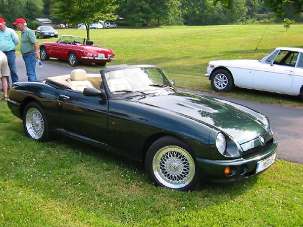

Looking at Scott's MG RV8 you might think it was all factory-built, but it wasn't! Scott began his project in 2001 when he got in touch with an individual in the UK who was selling a set of OEM RV8 body panels. This individual had also commissioned Heritage to build a "one off" body-shell for use with these panels. Scott bought the entire package, and had it crated-up and shipped here in pieces.
Scott's car at the BritishV8 2006 meet in Townsend TN
Scott's RV8 at the BritishV8 2006 meet in Townsend TN

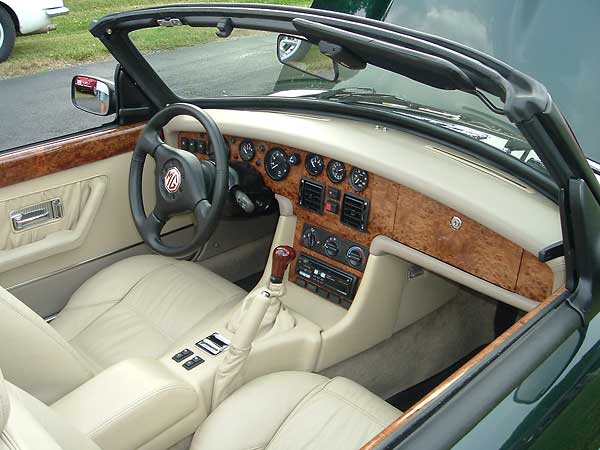

And how about left-hand drive? The majority of the car was assembled from OEM RV8 parts purchased and shipped from the UK. Scott's steering, however, is based on an MGB rack. The easy part was getting the rack. The hard part was integrating it with the steering column and dashboard trim.
Think about what had to be done to make this conversion work. The dash had to be built in a mirror image. Glove box on the right, gauges on the left. (Scott procured OEM RV8 gauges, produced by VDO.) After much research, Scott was able to locate someone in England who had created fiberglass molds of the crash-pads in LHD form. The wood trim insert was custom made for Scott by the company who supplied the originals to British Motor Heritage. The metal backing plate was a RHD unit that Scott reworked into LHD form. The dash itself was custom made from burled elm, and is a thing of beauty. The leather work (crash pads, center console, and interior panels) was done by a Columbus OH based trim company. Pedals? Gas, brake, and clutch pedals, with respective master cylinders and linkages, presented more challenges. Scott estimates that all of these changes added at least one year and $10K to the project.

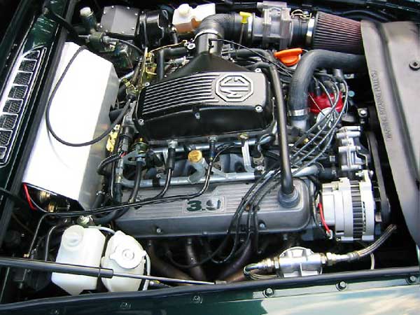

Scott's carefully detailed engine compartment
There are other specification differences between Scott's car and standard MG RV8's. One difference is the engine. The stock RV8 used the Rover 3.9 liter V8, whereas Scott's engine is a "4.0". What's the difference? The 4.0 is an upgraded 3.9 that includes cross-bolt mains and improved block webbing, plus stronger connecting rods, etc.
Notice the MG logo on the plenum of Scott's fuel injection system, just like the factory RV8's. The gasoline is supplied by a Bosch GPH fuel pump. All of the power is transmitted through a Rover LT77 five-speed gearbox, which is the exact model used in the stock RV8 (with ratios of 3.32, 2.09, 1.40, 1.00 and 0.79:1 respectively.) The gearbox was purchased through Victoria British.

Scott Miller's One of a Kind Left-Hand-Drive RV8 Interior

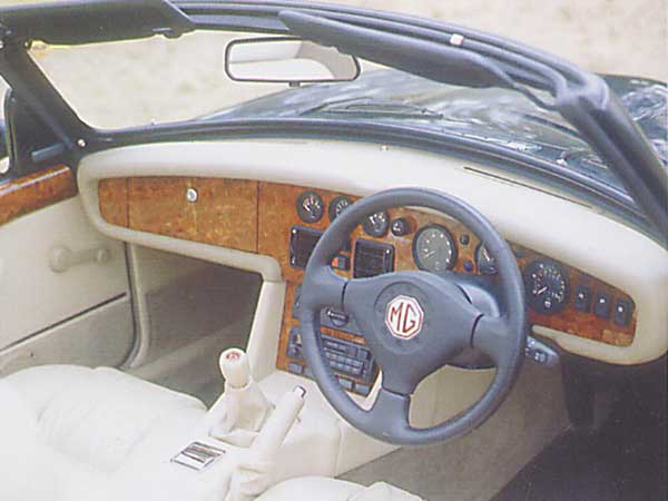

Reference: Standard (RHD) RV8 Dashboard

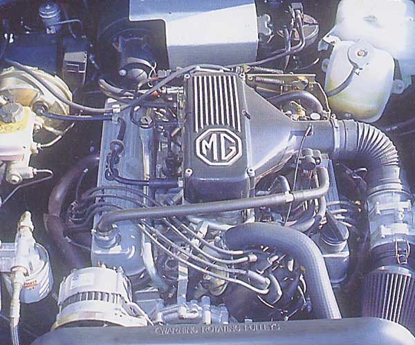

Reference: Standard (RHD) RV8 Engine Compartment
