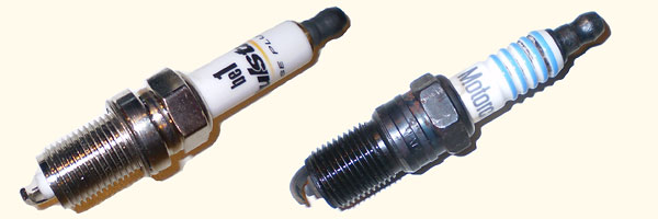

Pulstar be1 Spark Plug
One of Larry's new Pulstar spark plugs, side-by-side with the Motorcraft plug it replaced
Notice that the two plugs seal differently. The Pulstar plug is flat and uses a gasket,
whereas the original Motorcraft plug has a tapered seat. Both plugs seem to seal fine.
