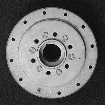

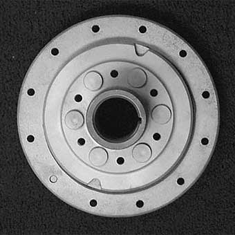

Photo 1 - 1193961 - Front     Photo 2 - 1193961 - Back

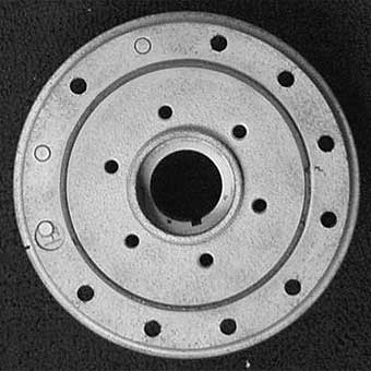

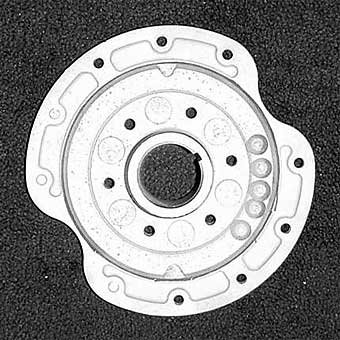

Photo 3 - 578785 - Front     Photo 4 - 578785 - Back

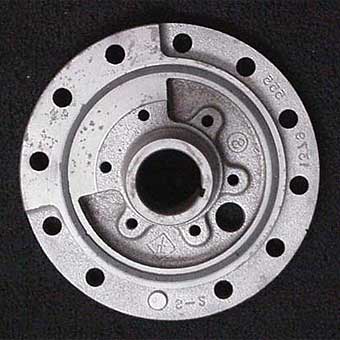

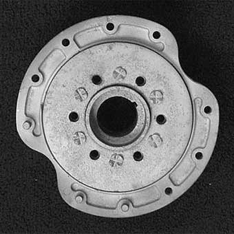

Photo 5 - 1379555 - Front     Photo 6 - 1379555 - Back

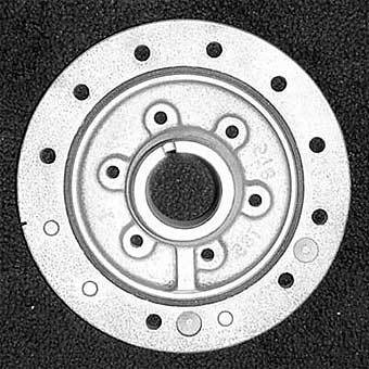

61-62 F85&CutlassG all 578785-or-578784  4.66# 3&4

'61Special & SkylarkHall11939616.74#  1&2

'64-'75300/340/350 engine   1379555 4.94#  5&6
