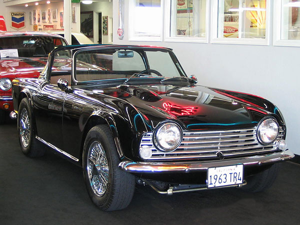

Art Hart's 1963 TR4 with Ford 302 V8 Engine
Art Hart's 1963 "Surrey Top" TR4 with Ford 302 V8 Engine
Owners: Art Hart
City: Ottsville, PA
Model: 1963 Triumph TR4 (with surrey top)

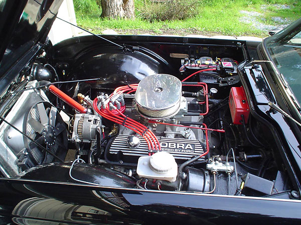

Engine: Ford 302, 350hp crate engine by The Engine Factory.
Conversion performed by: Dan Tyler of San Jose, CA
Engine: Ford 302, 350hp crate engine by The Engine Factory. Edelbrock "Performer RPM" intake manifold (#60259). Speed DeMon carburetor. Elgin hydraulic roller cam with 212 intake at 0.050, 222 exhaust at 0.050, 0.498 lift intake, 0.512 lift exhaust. 1:6 ratio roller rockers. MSD 6AL ignition. Custom engine mounting, using motor mounts from a 1968 383 Plymouth Satellite.
Exhaust: Cast iron Sunbeam Tiger exhaust manifolds. Stainless steel Magnaflow mufflers. Recently reconfigured by "Claude Mervine & Sons", Reading, PA which included adding a balance pipe and bungs in the down pipes for oxygen sensors.
Cooling: Be Cool aluminum radiator, 2800 CFM electric fan.
Transmission: Borg-Warner T5 5-speed manual transmission. McLeod hydraulic throw out bearing with Wilwood 5/8" master cylinder. Driveshaft custom made by Bayshore Truck Equipment Co. Modified stock transmission mounting.

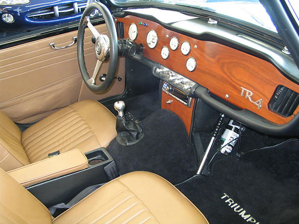

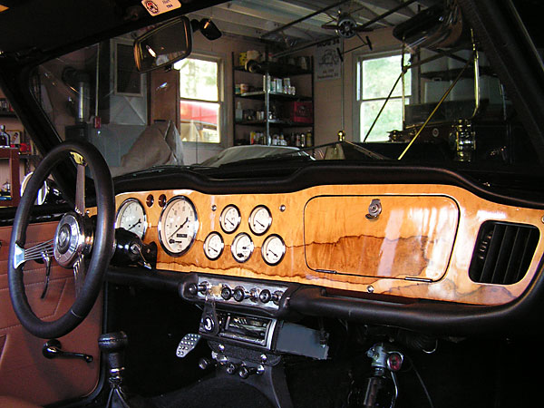

custom 1963 TR4 dashboard
New burled ash dashboard (installed January '08) with glove box and new gauges.
The dash as received when I bought the car...

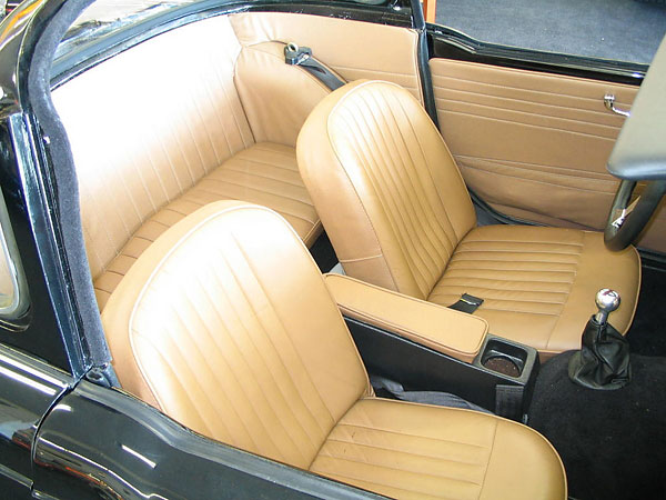

leather upholstery and trim from Moss Motors
New leather upholstery and trim from Moss Motors...

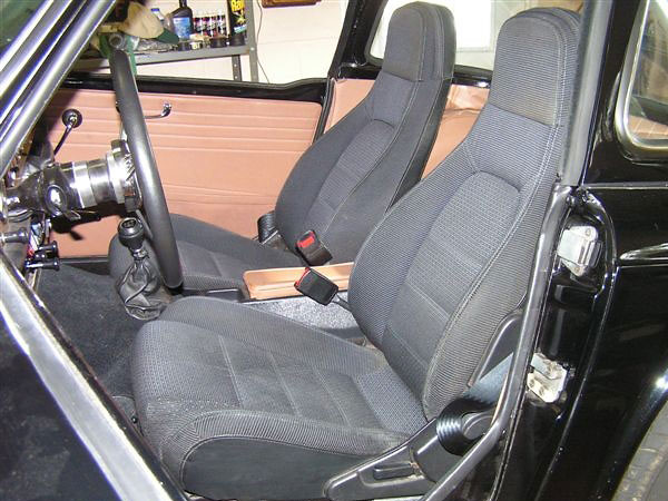

Mazda Miata (MX-5) seats
...but the Triumph seats weren't comfortable enough, so
Mazda Miata (MX-5) seats were installed in late 2008.

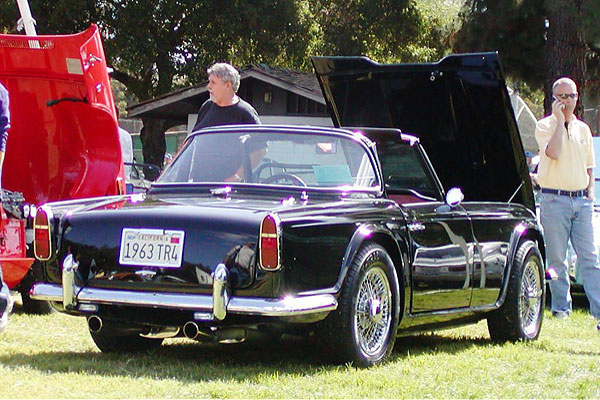

1963 TR4, from the rear
The rare surrey option provides more shelter than other convertible top designs.
All of the car's sheetmetal is original and rust free!

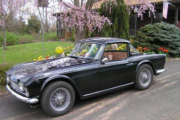

Triumph TR4 surrey option hard-top
The surrey hard top was bare aluminum when I purchased the car, but it's now been
painted body color and trimmed with new headliner fabric to match the interior.
