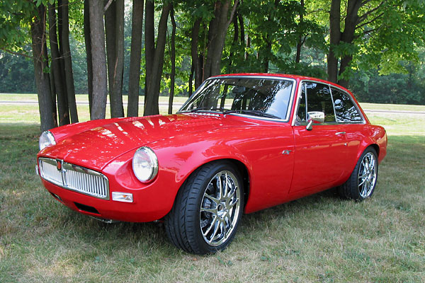

Terry Schulte's 1974 MGB-GT with Ford 5.0L V8 and Edelbrock EFI
Owner: Terry Schulte
City: Sioux Falls, SD
Model: 1974 MG MGB-GT
Engine: Ford 5.0L V8 with Edelbrock EFI

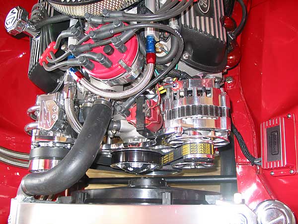

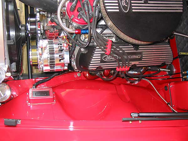

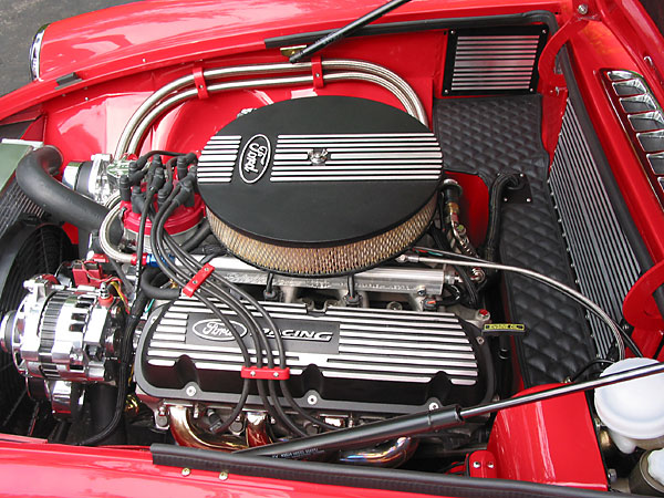

Engine: Ford 5.0L V8 with aluminum heads. Front Runner serpentine belt system. Remote oil filter mount.
Induction: Edelbrock Performer RPM Pro-Flo EFI system (developed by Magnetti-Marelli). Edelbrock Super Victor 8.2 EFI manifold.

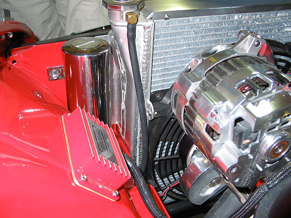

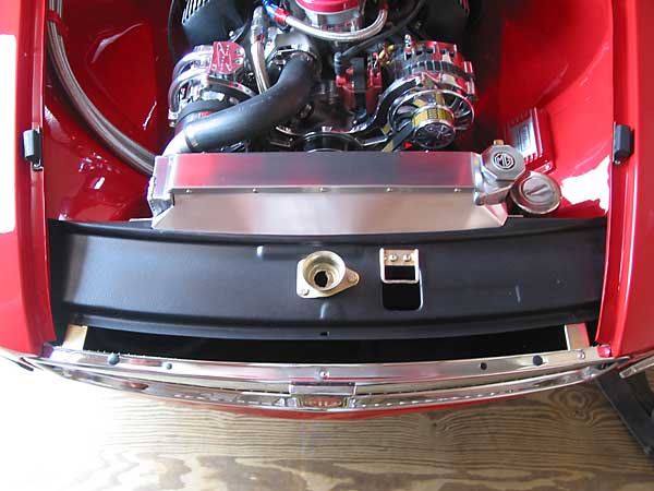

Cooling: aluminum radiator. 16" electric fan (pulling).
Exhaust: Fast Cars Inc. block-hugger 4-into-1 shorty headers. All stainless steel exhaust system.
Transmission: Borg-Warner T5 5-speed.

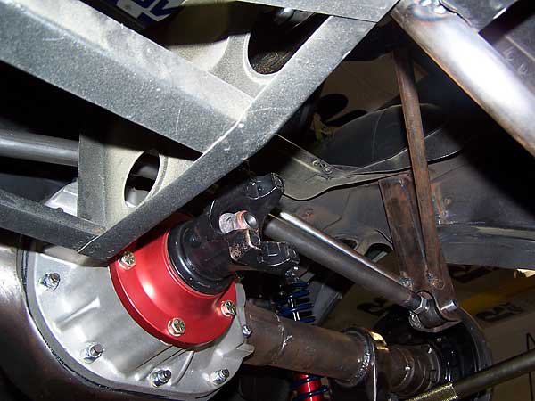

Rear Axle: Currie 8" Ford rear axle with aluminum differential carrier, LSD, and 3.XX:1 gears.

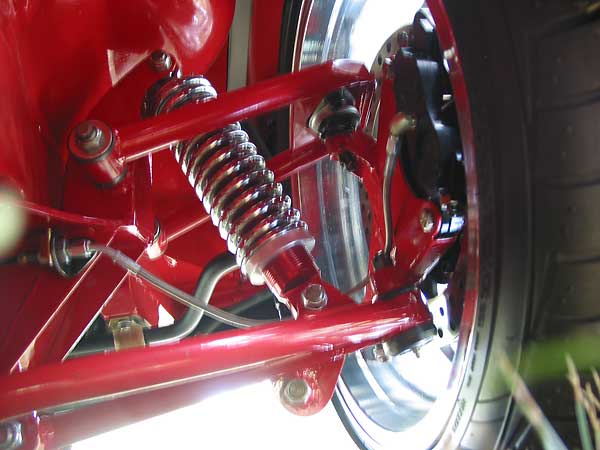

Front Susp. : double A-arm suspension by Fast Cars Inc., featuring coil-over shock absorbers.
Rear Susp. : 3-link rear suspension by Fast Cars Inc., featuring coil-over shock absorbers.
Brakes: Wilwood disc brakes, front and rear. Wilwood residual pressure valves.

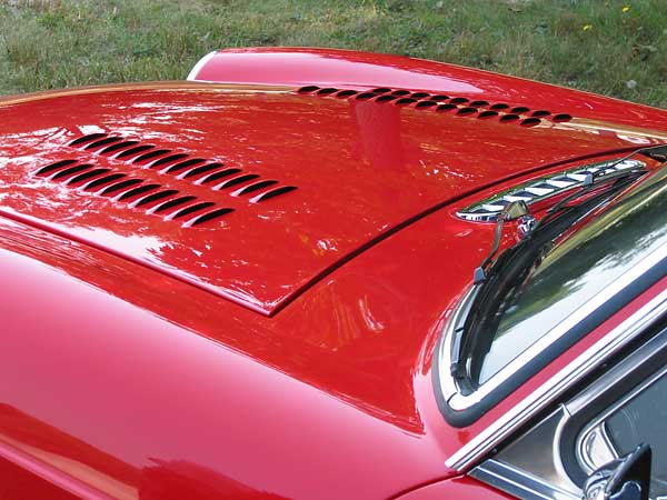

Body: bodywork subcontracted by Fast Cars Inc. to Don Marcott (of Wayland MI): Dodge Omni fender flares, front and rear. Sebring style front valance, blended into fenders. Sebring style rear valance with frenched-in license plate, blended into quarter panels. LeMans style fuel filler cap (relocated to passenger-side quarter panel.) Louvered hood.
Ferrari "Corsa Rosa" paint. Quilted / embroidered hood and firewall insulation.

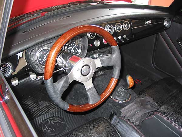

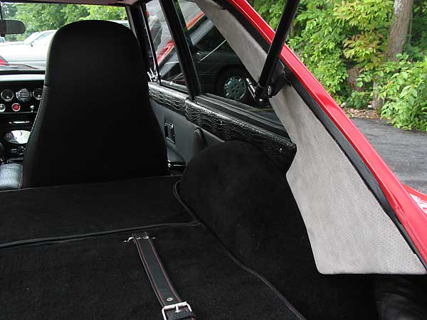

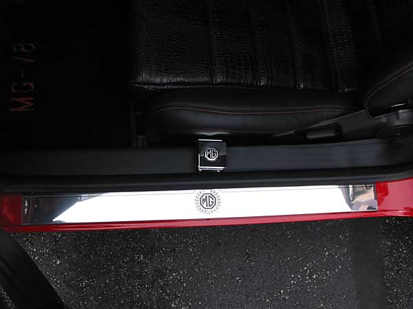

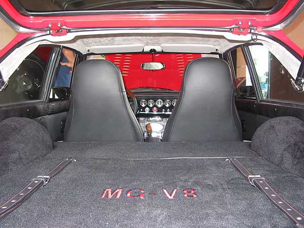

Interior: Vintage Air air conditioning system. Painted steel dashboard by Fast Cars Inc. Custom center console (which hides the emergency brake lever.) Mazda Miata seats, reupholstered. Suede headliner. Custom door panels with Fiat 124 Spider armrests.
Electrical: H4 headlamps. Maserati toggle switches.

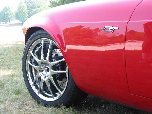

Wheels/Tires: 18" wheels. Bridgestone Potenza SO-3 tires
Executive Touch of Sioux Falls SD specializes in restoration and customization: quality work at a modest price

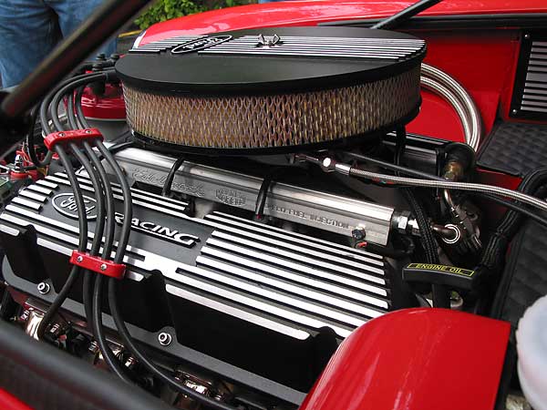

Edelbrock Performer RPM Pro-Flo EFI System
Magnetti-Marelli Electronic Fuel Injection (distributed by Edelbrock)
front runner serpentine belt system
Fast Cars block hugger 4-into-1 shorty headers

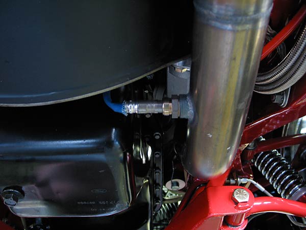

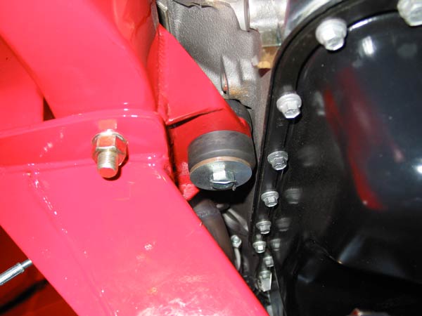

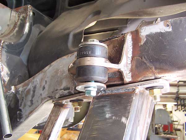

motor mount... to chassis rail, not to Fast Cars suspension raft
motor mount - installation completed

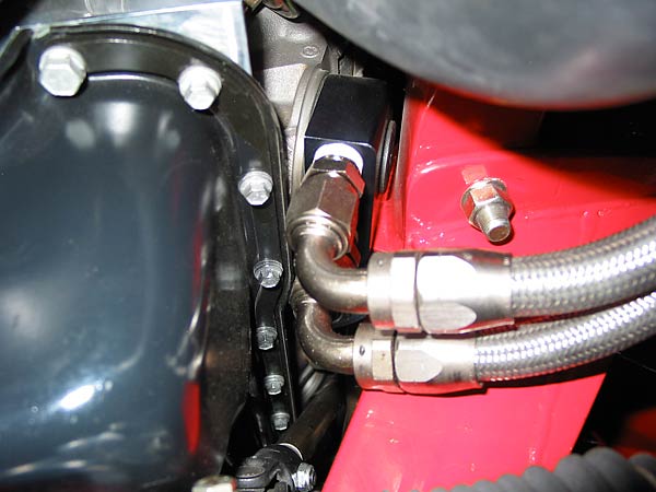

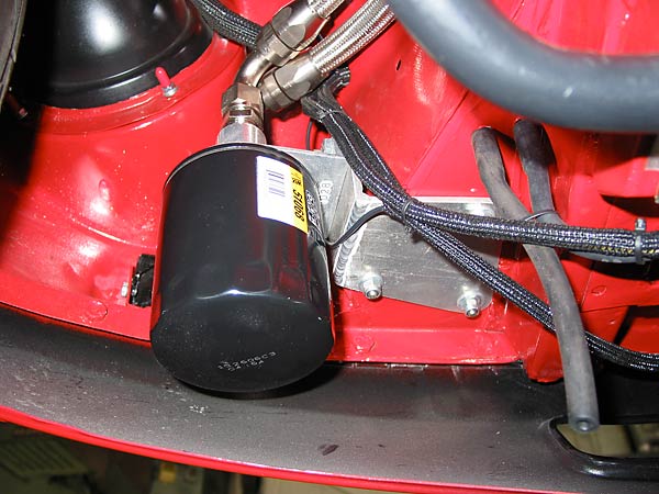

bypass to the remote mounted oil filter
Bypass for the remote mounted oil filter...
remote oil filter mount
...which is conveniently mounted behind the drivers-side headlamp.

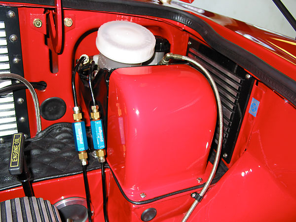

residual pressure valves provide a firmer brake pedal
Residual pressure valves provide a firmer brake pedal.

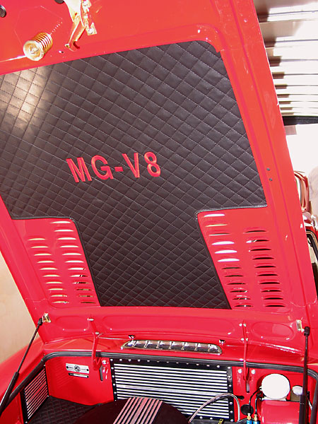

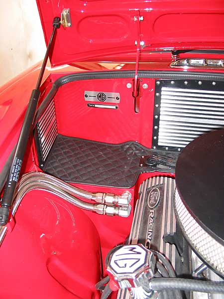

overkill: quilted and embroidered hood insulation blanket

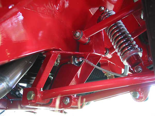

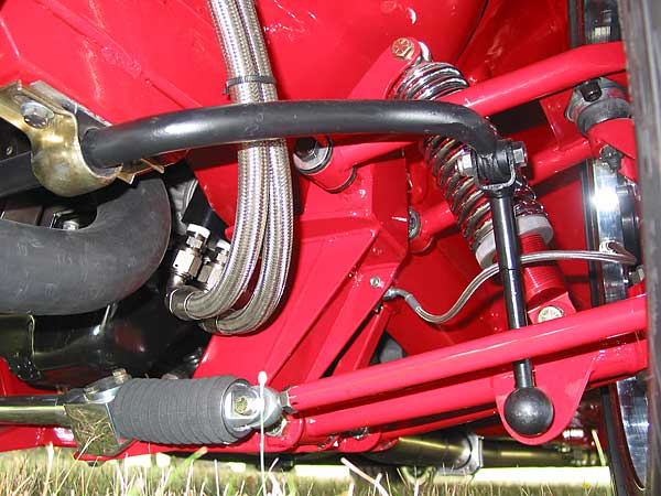

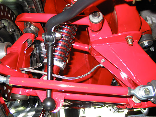

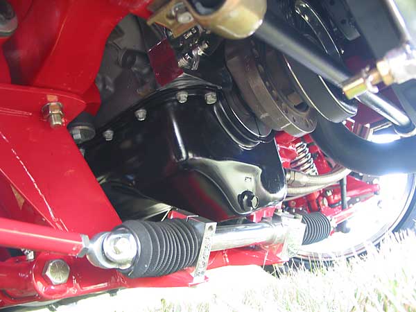

Fast Cars Independent Front Suspension
notice that the sway bar chassis mounts are spaced down about two inches
sway bar links have been shortened to suit the lowered sway bar mounting
Fast Cars front suspension

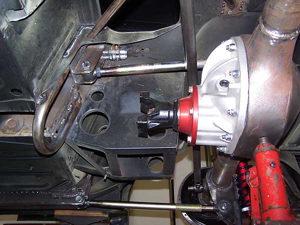

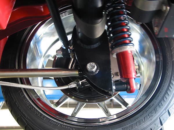

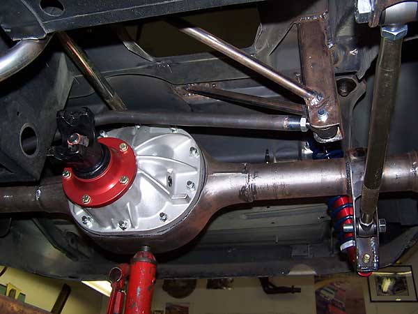

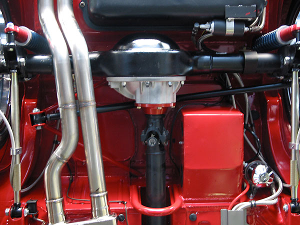

Fast Cars 3-Link Rear Suspension

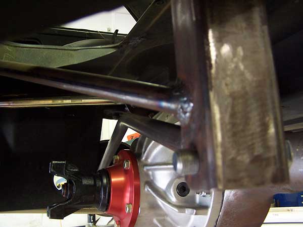

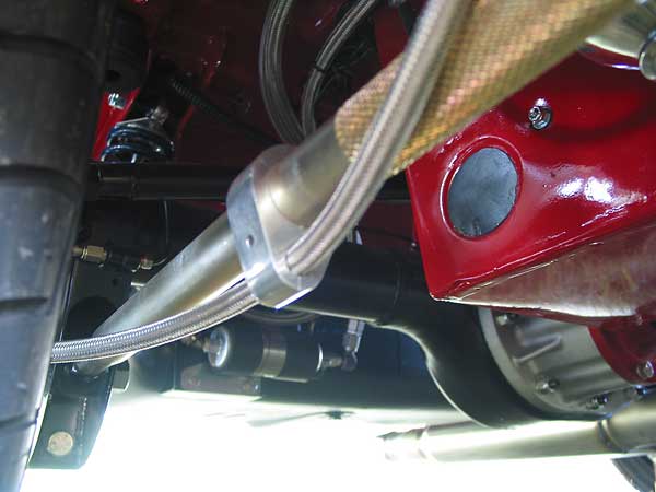

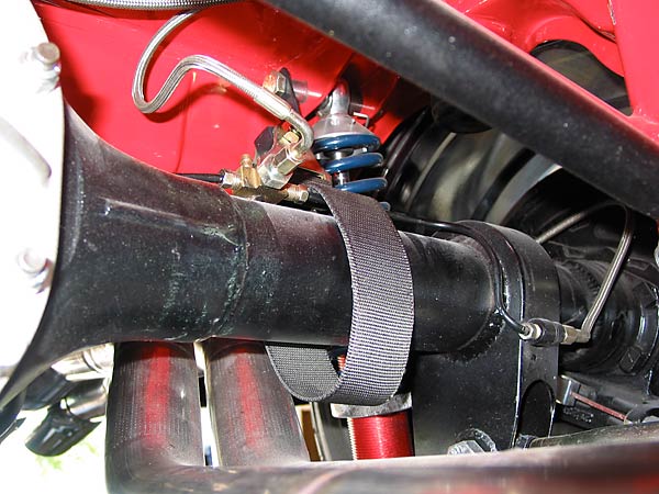

Currie eight inch Ford rear axle with aluminum differential carrier

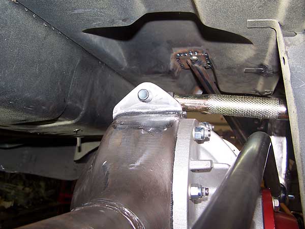

top-link mounting on the center of the rear axle differential case

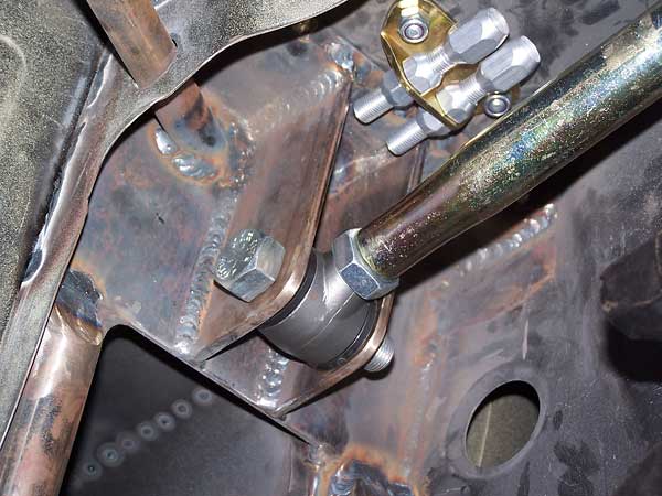

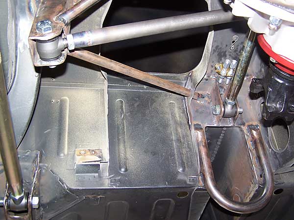

top-link bracket - for the three-link rear suspension

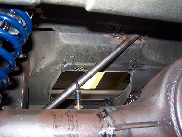

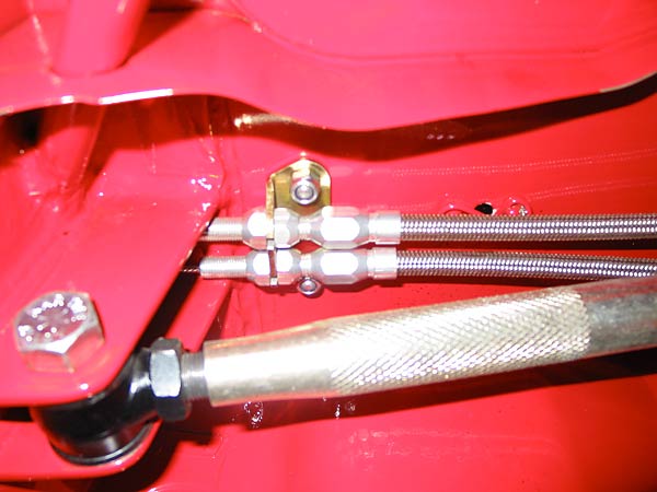

the Panhard rod doglegs over the differential pinion
Panhard rod chassis bracket and tubular driveshaft tunnel reinforcement
is that just a vent? (coming out of the Ford 8 inch axle tube)

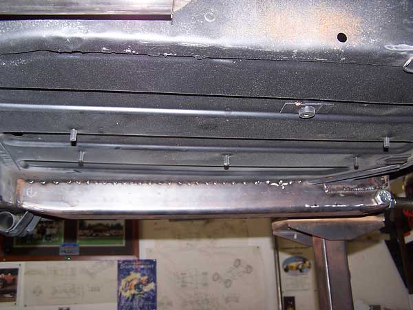

generously reinforced floorboard / suspension mounts

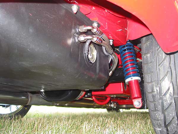

high volume fuel pump

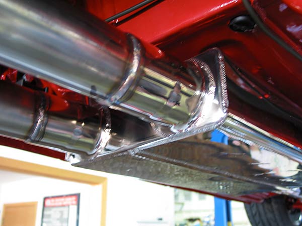

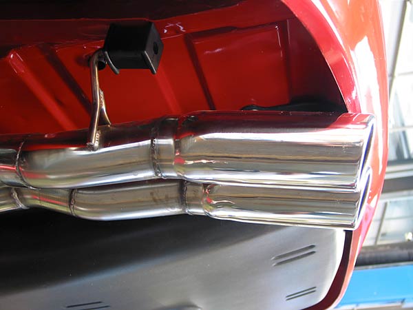

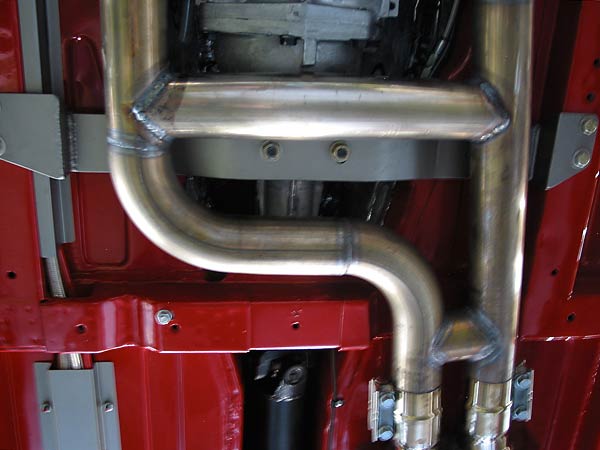

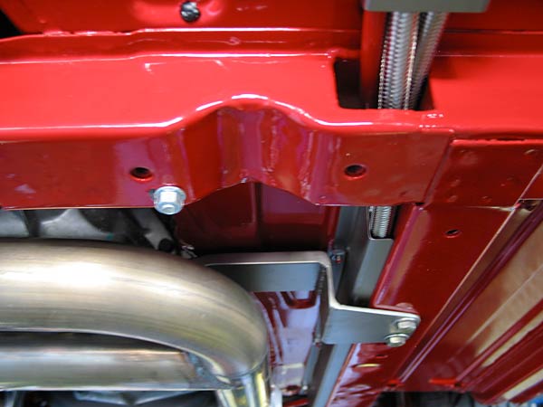

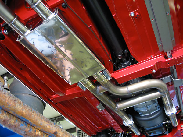

Exhaust System

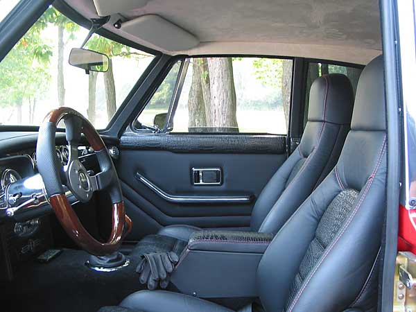

Fiat 124 Spider armrests, suede headliner
the climate system is from Vintage Air
those toggle switches are from a Maserati... and that's the remote for the stereo

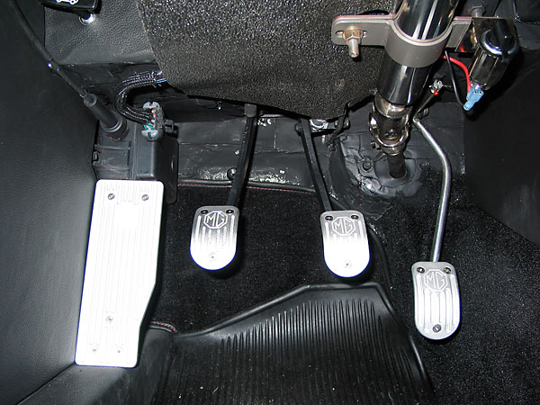

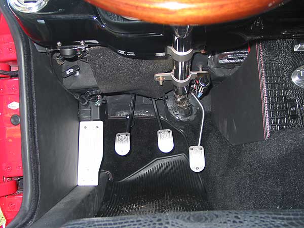

pedals, including a dead pedal at left
Neatly trimmed foot box, includes custom pedals and "dead pedal" (foot rest).
Looking closer, notice that a steering universal joint is hidden here, above the throttle pedal!

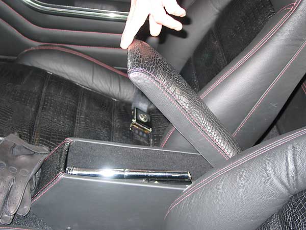

chrome parking brake lever discrete hidden in the center console
well presented seat belts... probably haven't been worn yet

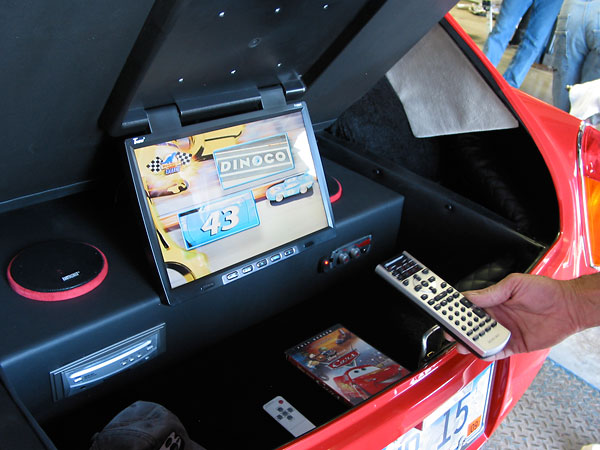

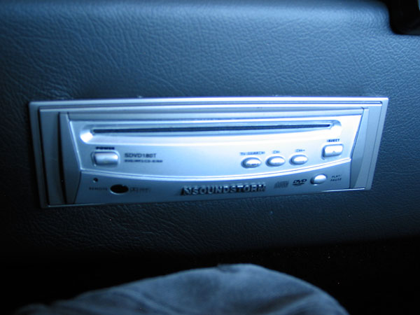

stereo radio, amp, and CD changer are hidden behind the seats... under this lid
Mazda Miata seats, obviously re-upholstered

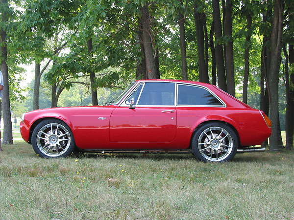

later model MGB side view mirrors (these started in 74)

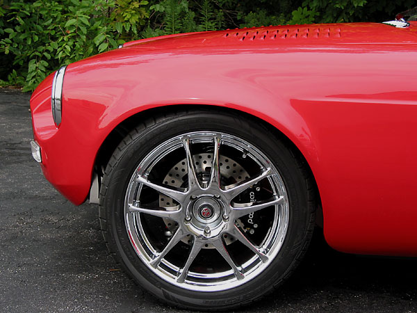

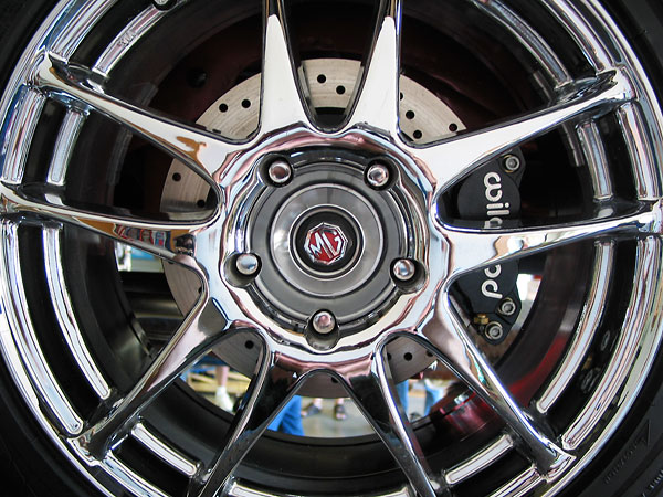

one thing I'll say for those wheels... they show off the Wilwood rotors

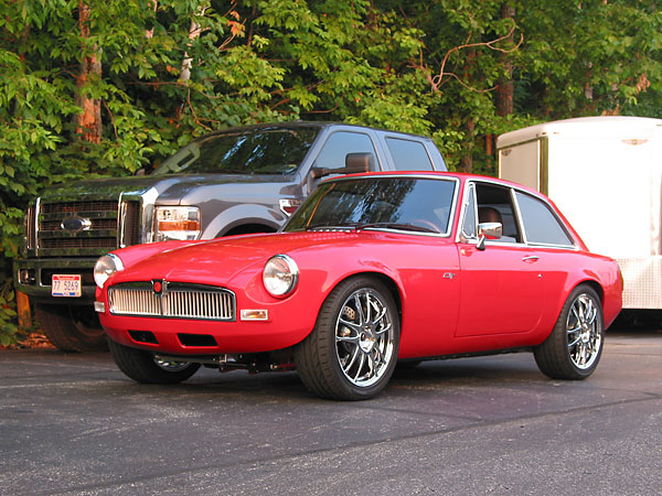

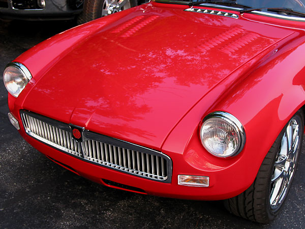

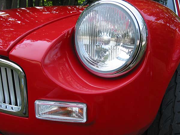

blended in front valance / gravel pan
this color is Ferrari Corsa Red
hood louvers
European spec H4 headlamp

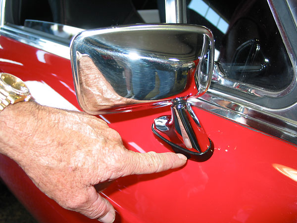

custom mirror plinthe improves rearward visibility
Small custom plinths lift the mirrors slightly higher for better rearward visibility.

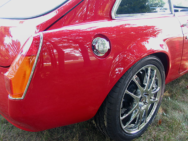

lemans style fuel filler

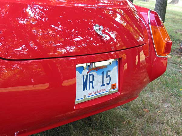

frenched license plate
