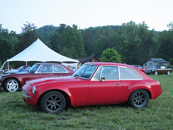

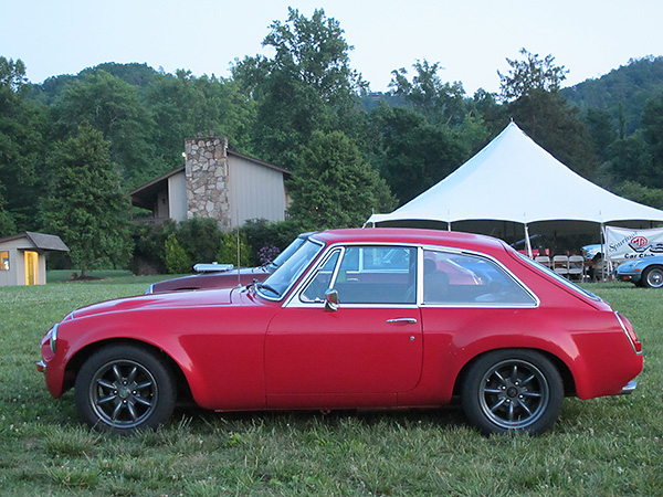

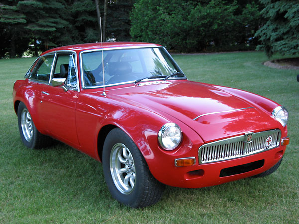

Mike Maloney's 1974 MGB-GT with 3.9L Rover V8
Owner: Mike Maloney
BritishV8 UserID: RMO_699F
City: Tipp City, OH
Model: 1974 MGB-GT
Engine: Rover 3.9 V8
Conversion by: Tom Hoagland
(as photographed at British V8 2008 in Port Washington, WI)

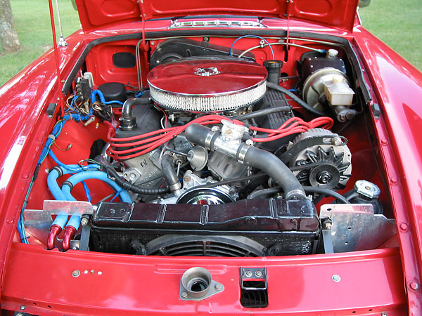

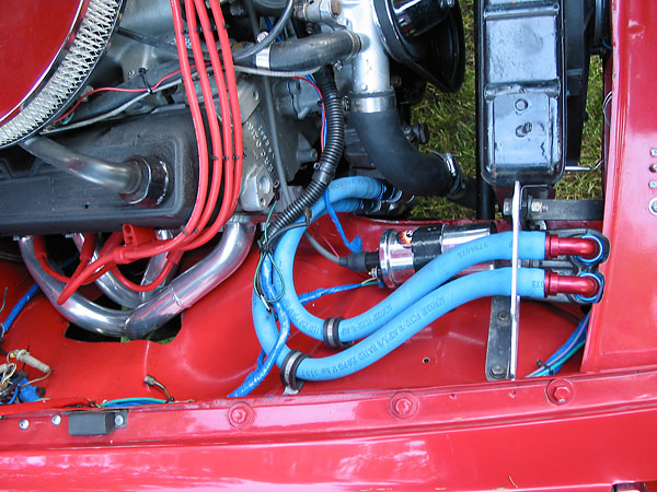

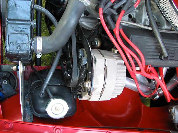

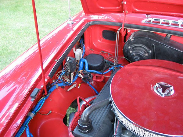

Engine: Rover 3.9L V8 rebuilt with 9.35:1 compression ratio pistons (stock bore) and a 10-10 grind on the crankshaft. Crower 50230 camshaft. Duplex timing chain. Upgraded oil pump. Remote oil filter. Buick four-barrel intake manifold. Edelbrock 500 carburetor. Pertronix "Ignitor" breakerless ignition and Pertronix "Flame Thrower" coil. Delco-Remy alternator.

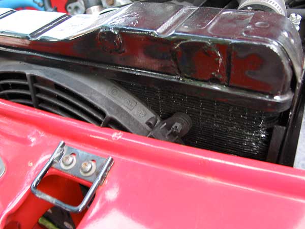

Cooling: later model ("rubber-bumper") MGB radiator with inlet and outlet ports repositioned (i.e. the original port locations are blanked off.) Spal electric cooling fan (pushing).

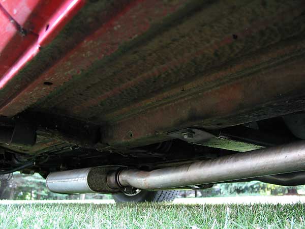

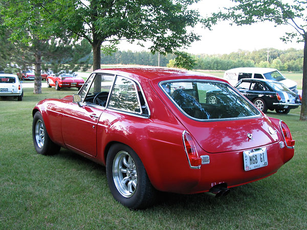

Exhaust: MG RV8-style (through-the-apron) 4-into-1 headers going into a single muffler.
Transmission: Borg-Warner T5 (nwc) 5-speed, with 0.073:1 fifth gear. 10" clutch with McLeod HTOB. Custom driveshaft.
Rear Axle: Clive Wheatley 3.07:1 CW&P installed in the MGB axle. (0.218 thousandths removed from original MGB carrier.)
Front Susp.: standard, with castor reduction wedges fitted (to reduce steering effort).
Rear Susp.: standard, with tube shocks in lieu of lever shocks.
Brakes: standard MGB brakes.
Wheels/Tires: Konig "Rewind" 8-spoke aluminum wheels, 15x7 with zero offset.

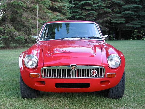

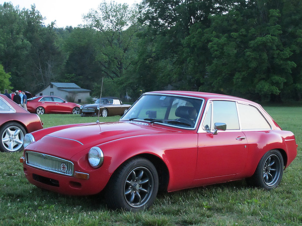

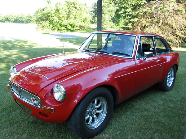

Body: Complete MGC-GT "Sebring" body kit, including fiberglass flared fenders and valances.

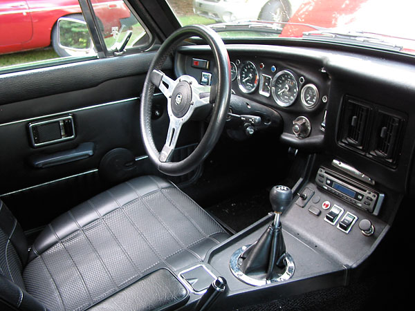

Interior: Mountney 14" steering wheel.
Electrical: MGB wiring harness, refurbished. Two 12V batteries hooked up in parallel with separate grounds, in original battery boxes.
Completed: 5/1/2007. Approximately 3,000 miles driven as of British V8 2008.
Comments: I originally purchased this car from a Ford dealer in San Angelo Texas. The previous owner had traded it in on a "150" pickup! It came with the Sebring body kit and also had a fiberglass MGC hood with an extra hood scoop. (It now has standard MGC hood.) I originally installed a Chevy 4.3L V6 obtained from a 1988 Astro minivan. It ran with a 3-speed automatic. The V6 headers were piece cut and tack-welded from three complete sets of tubular Astro van headers. I never was happy with this arrangement and when Tom Hoagland offered to install the 3.9 V8 in 2007, I jumped at the chance. The Clive Wheatley 3.07 CW&P was installed by Babbitt Bearing in Columbus, Ohio. I highly recommend these folks.
Rover 3.9 aluminum engine

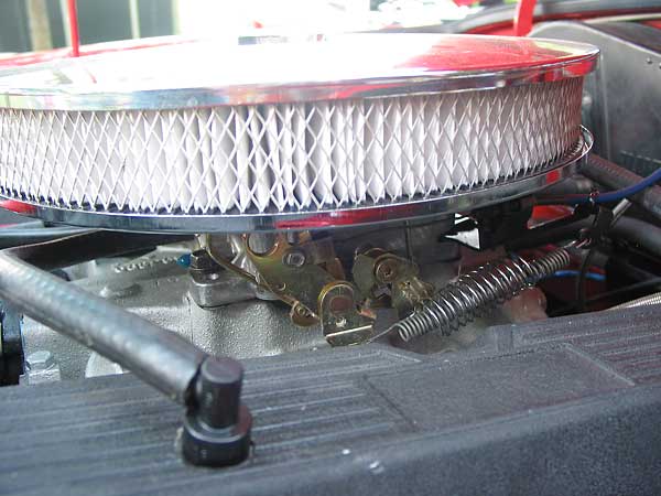

Edelbrock 500cfm four barrel carburetor
Delco alternator

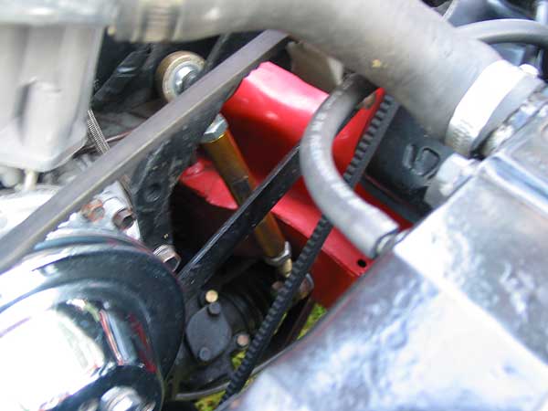

torque rod to subdue engine rotation
modified MGB radiator, with Spal electric fan
remote oil filter

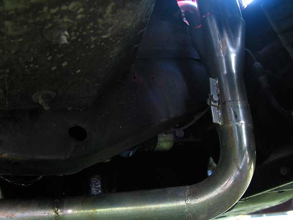

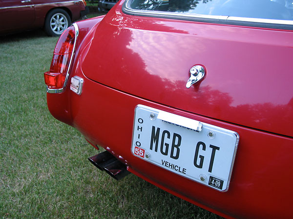

through-the-fender headers
header slip coupling
muffler
MGB GT interior with Mountney steering wheel
MGC hood
MGC bonnet
Sebring flares
MGB GT license plate

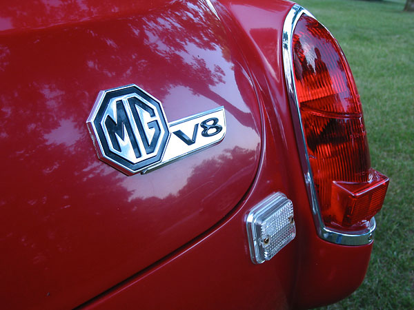

MG V8

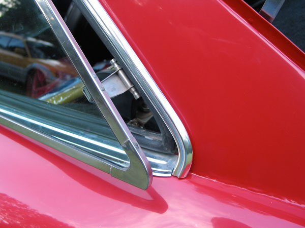

rear quarter windows in vented position
