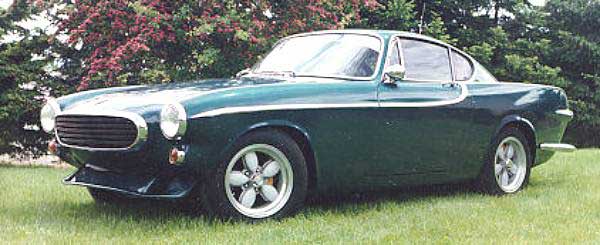

Dale and Larry Rembold's 1962 Volvo P1800 with Ford 289 V8
Dale Rembold's Volvo P1800 with Ford 289 V8
Dale Rembold's 1962 Volvo P1800 with Ford 289 V8

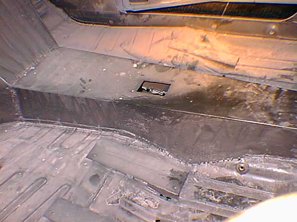

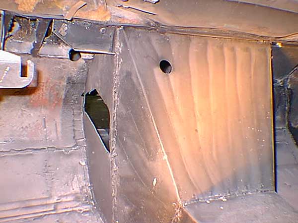

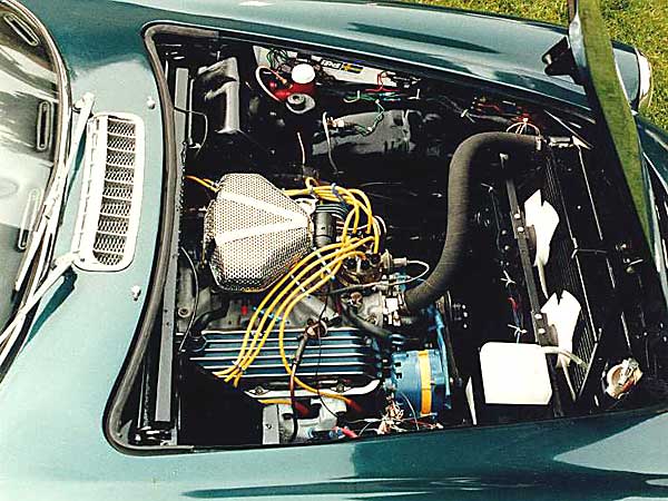

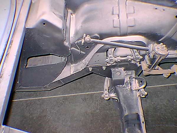

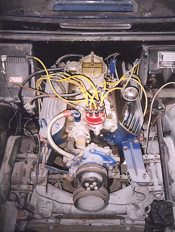

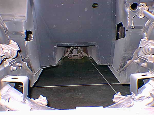

Dale and Larry Rembold are co-owners of this Ford powered P1800 that they like to call "The Super Peanut." The conversion is similar to a Ford 289 P1800 conversion found in the December 1964 issue of Hotrod Magazine. As built by Dale and his sons, the engine sits well back into the firewall to clear parts in front, like the front crossmember and steering. This engine placement also helps keep weight distribution reasonable, although it required major reconstruction of the firewall and driveline tunnel. The footbox had to be narrowed from stock, but it's still approximately as large as an MGB's. Pedals and master cylinders had to be moved. Rear sparkplugs are changed from inside the car via access panels! The electric cooling fans are from a Jaguar.

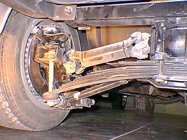

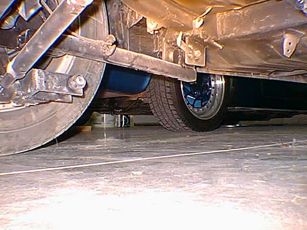

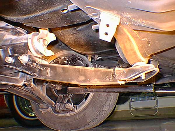

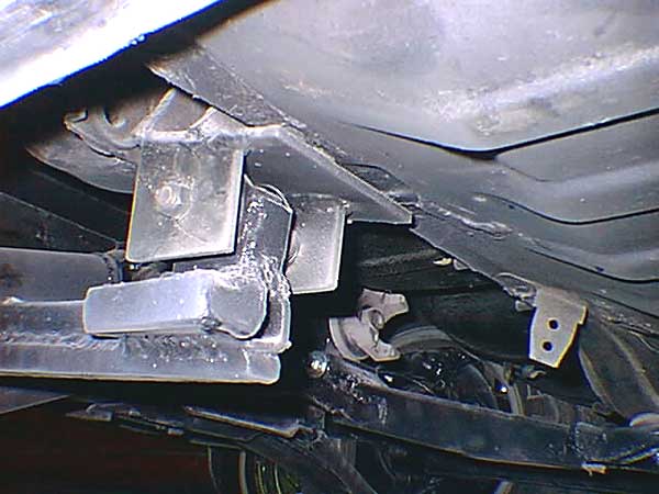

The front suspension is stock, but unlike the Hotrod Magazine P1800 Dale and Larry's car has transverse leaf-spring IRS suspension from a 1966 Corvette. (It had to be narrowed, of course.) Their car also differs from the Hotrod Magazine P1800 in that it has a Borg Warner T10 four-speed transmission.

Dale's Ford 289 V8 powered Volvo P1800
Ford 289 V8 in Dale Rembold's Volvo P1800

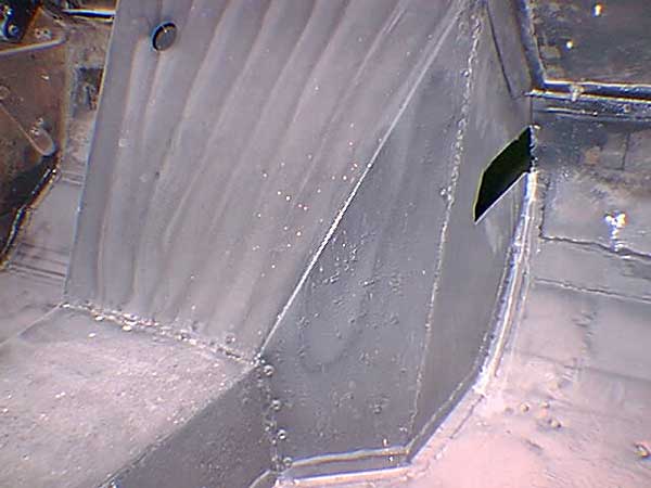

Dale Rembold's Volvo P1800 - firewall
Dale Rembold's Volvo P1800 - tranny tunnel
Dale Rembold's Volvo P1800 - transmission tunnel
Dale Rembold's Volvo P1800 - driveshaft tunnel
Volvo P1800 - Corvette independent rear suspension
Volvo P1800 - Corvette transverse leaf spring
Volvo P1800 - Corvette pinion snubber
Volvo P1800 - Corvette trailing link
Volvo P1800 - Corvette rear suspension
