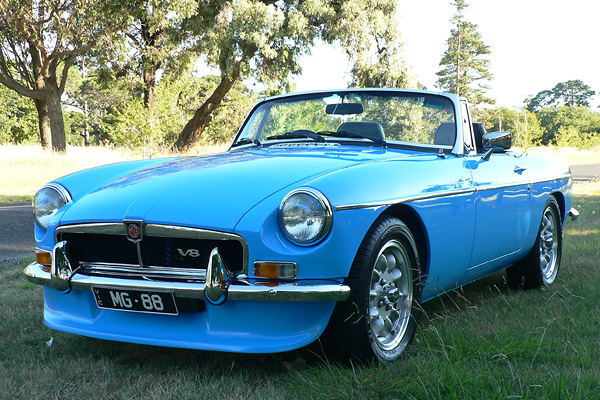

Steve Quilliam's 1975 MGB, upgraded with Rover 3.5L V8 and Toyota 5-speed

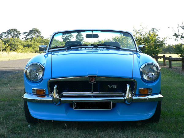

Steve Quilliam's 1975 MGB with Rover 3.5L V8 and Toyota 5-speed
Owner: Steve Quilliam
City: Victoria, Australia
Model: 1975 MG MGB (U.S. spec)
Engine: Rover 3.5L V8
Built by: owner.

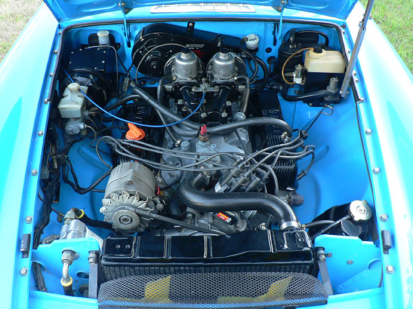

Engine: Rover 3.5L V8 engine. Scorcher electronic distributor. Twin S.U. carburetors.
Cooling: MGB V8 radiator with electric fans. Oil cooler.

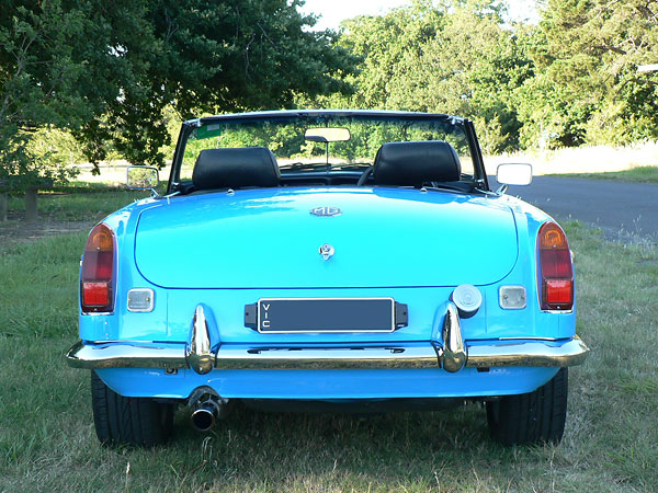

Exhaust: 4-into-1 block hugger headers.
Transmission: Toyota Supra 5-speed transmission.
Rear End: stock MGB (Salisbury) axle, including 3:909:1 gears and open differential.

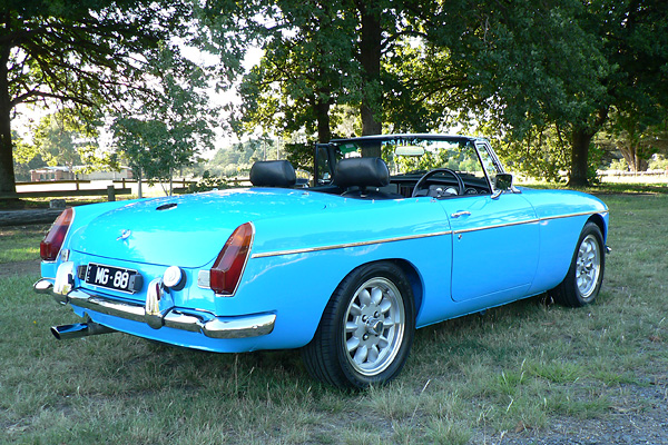

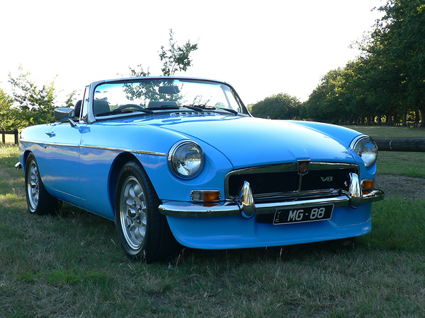

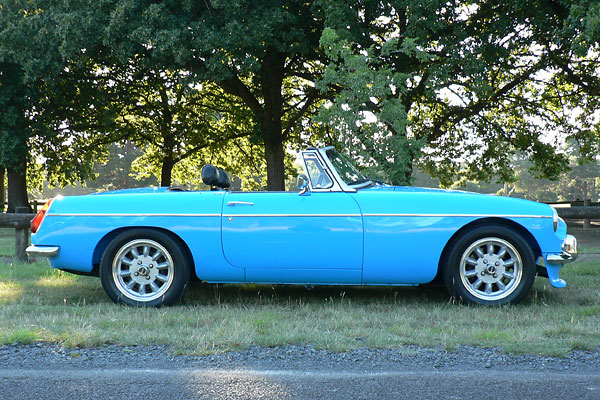

Front Susp.: stock, except lowered and converted to righthand drive.
Rear Susp.: stock, except lowered.
Brakes: stock.

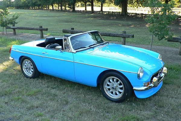

Wheels/Tires: Minilite 15x7 ten spoke aluminum wheels.
Electrical: Delco-Remy alternator.

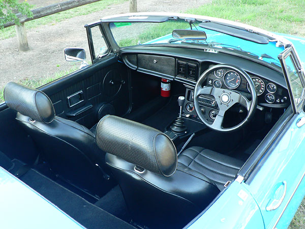

Interior: converted to righthand drive. Aftermarket steering wheel. Stereo radio.
Exterior: Chrome bumper conversion, including removal of U.S.-spec side indicator lamps.
Rover 3.5L V8 engine with twin S.U. HIF6 carburetors.
