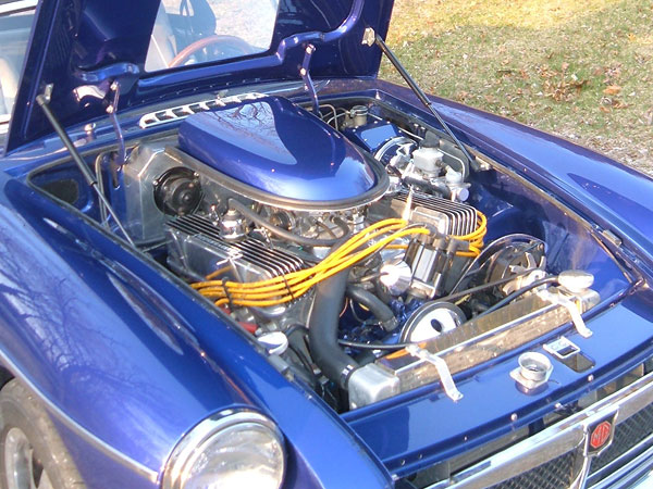

Engine: 1964 Buick 300, 4bbl high compression model, Carter 500 cfm carburetor, Crower cam & lifters, double roller timing chain, high volume oil pump, Pertronix ignition

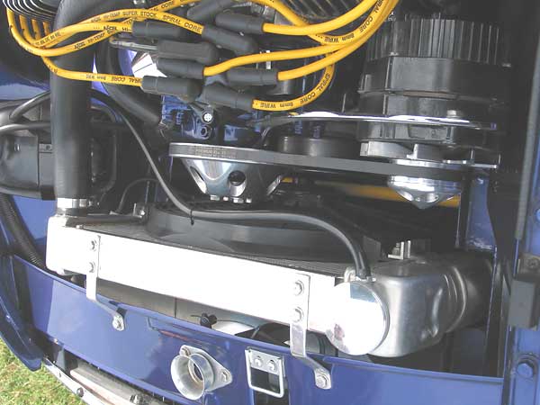

Cooling: cross-flow Griffith aluminum radiator

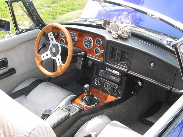

Instruments: Stewart-Warner in mahogany dash inlay

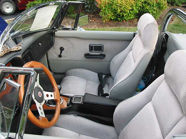

Notes: louvers in hood for heat extraction, RV8-style hood bulge, welded & filled body seams, back-up lights, side marker lights, & locks. Power antenna, chromed windshield frame, chrome-bumper conversion, interior reupholstered in dove grey, Fiero seats (with headrest speakers)

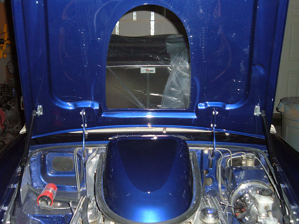

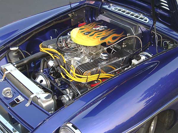

New cowl induction system (installed in 2011.)

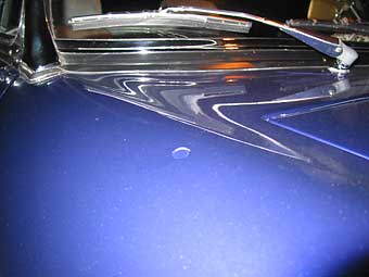

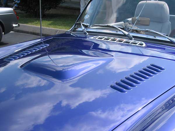

Preform Resources fiberglass hood.
A new fiberglass hood from Preform Resources was the basis of this development.
cowl induction air cleaner details
rear mounted air cleaner assembly
(Previous rear-entry air cleaner.)

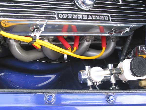

Offenhauser valve covers for Buick 300
1964 Buick 300 V8 block hugger headers
1964 Buick 300 V8 billet pulleys

MGB wooden dashboard inserts and steering wheel
1978 MGB Pontiac Fiero Seat Installation

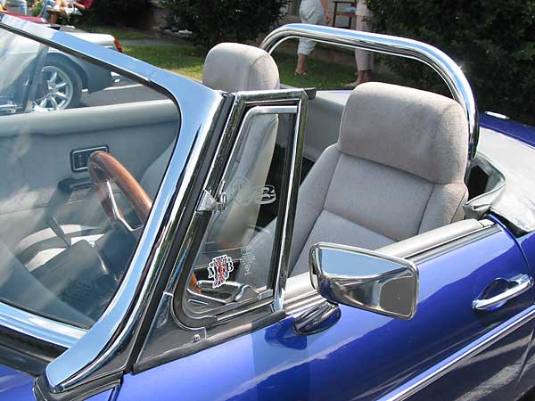

etched-glass MGB vent-a-plane windows

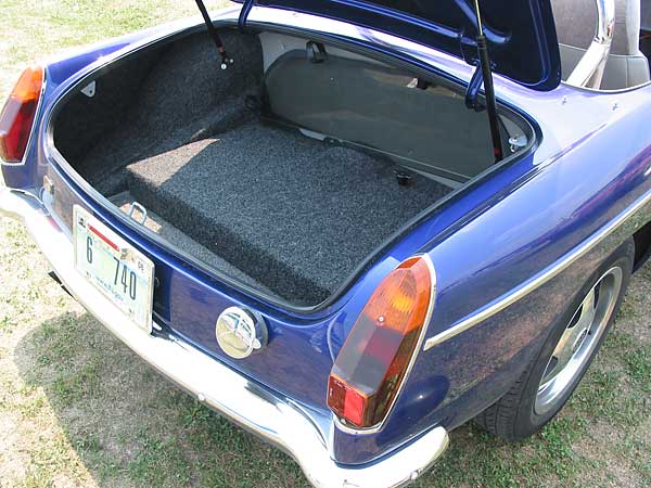

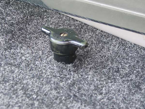

trunk lining, battery disconnect switch
Mil-Spec battery disconnect switch, mounted in trunk floor

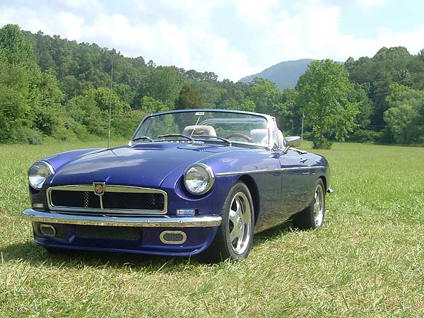

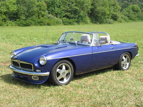

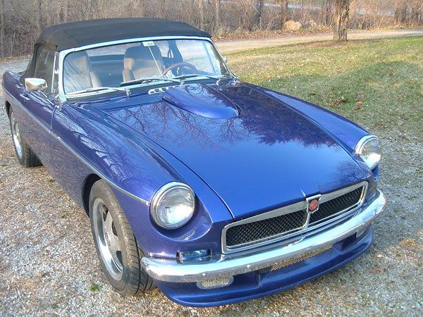

Glamour Shot of Mikel Moor's 1978 MGB

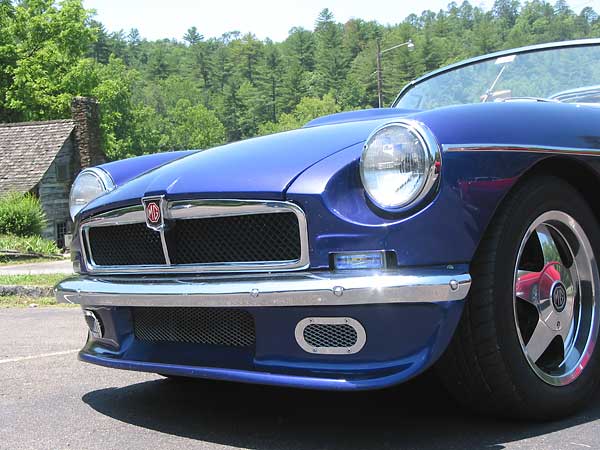

Front View of MGB Chrome-Bumper Conversion
RV8-style MGB hood bulge and cooling vents

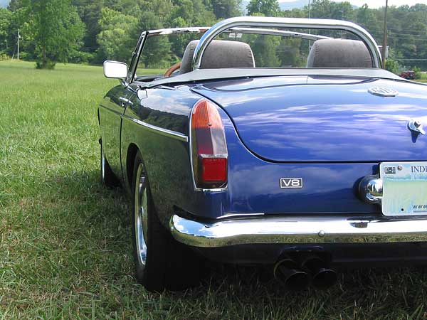

V8 badge and roll hoop
Rear View of MGB Chrome-Bumper Conversion

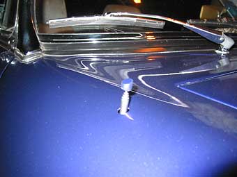

MGB electric antenna installation   isn't that neat-o
