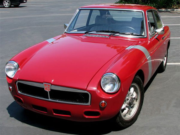

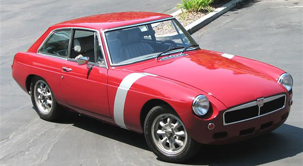

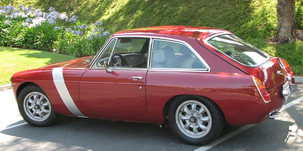

Jim Lewenauer's Rover aluminum V8 powered 1974.5 MGB-GT
Owner: Jim Lewenauer
City: Mequon, WI
Model: 1974.5 MGB-GT
Engine: 4.2L Rover aluminum V8
Conversion by: Tom Hoagland, Richland Motor Cars

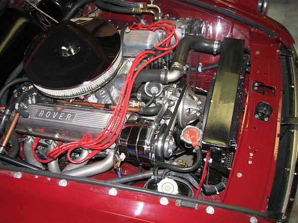

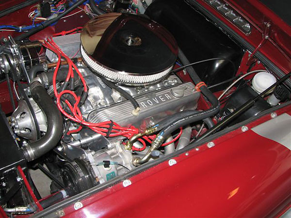

Engine: 4.2L Rover aluminum V8 engine, rebuilt with all new wear items (including rings, bearings, gaskets, cam, lifters, seals, etc.). Standard bore and grind. Offenhauser intake manifold (ceramic coated). Edelbrock 500cfm carb with low-rider air filter. Pertronix Ignitor ignition. Melling high volume oil pump. Alternator and A/C brackets are ceramic coated. Rover aluminum valve covers. TSI geared reduction starter.
Cooling: aluminum radiator with Spal 16" puller fan.

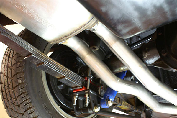

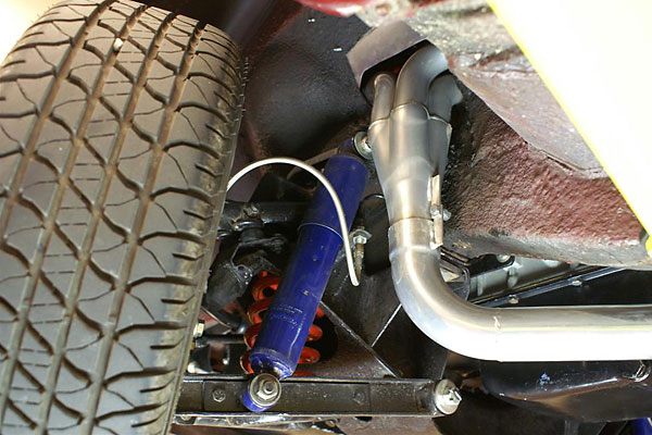

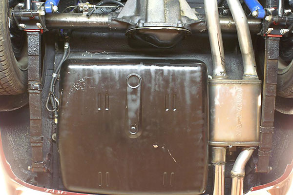

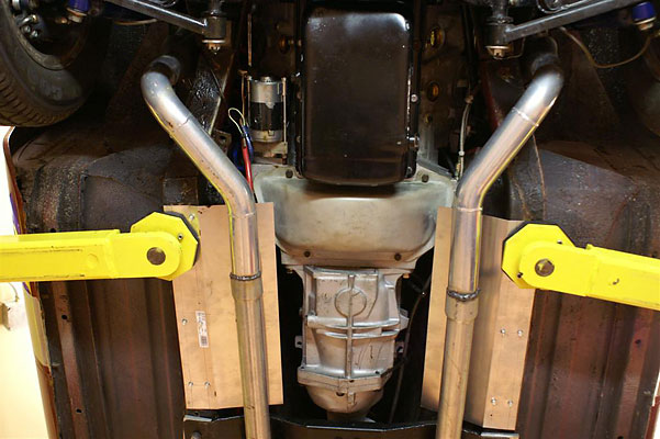

Exhaust: RV8-style 1-5/8" exhaust manifolds (ceramic coated) with dual exhaust. Magnaflow muffler.
Transmission: rebuilt Borg-Warner T5 ("World Class") 5-speed with 0.63:1 5th gear. Heavy duty 10" clutch assembly, lightened flywheel, and hydraulic throw-out bearing.

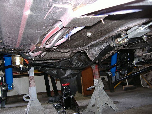

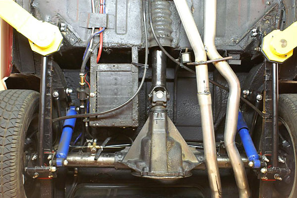

Rear Axle: new Chevy S10-spec (10-bolt) axle, narrowed. 3.63:1 final drive ratio.

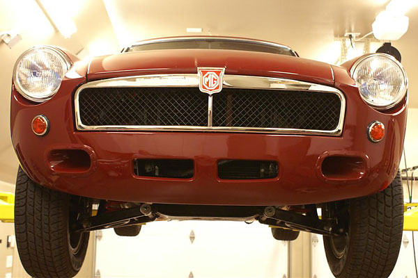

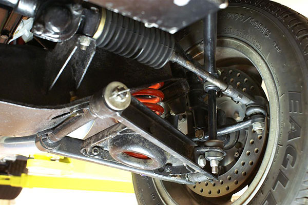

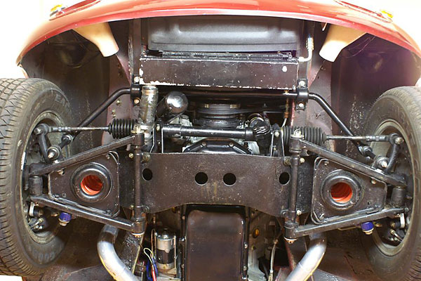

Front Susp. : lowered coil springs, oversized anti-roll bar, Monroe tube shocks, and polyurthane bushings.
Rear Susp. : De-arched springs, Monroe tube shocks, anti-tramp bars, and polyurethane pads and bushings.

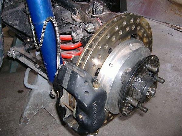

Brakes: Wilwood 4 piston calipers with cross-drilled, vented rotors.
Wheels/Tires: Saab/Shelby Minilite-style 15x6 wheels with Goodyear Eagle GPS 195/60R15 tires.
Exterior: basecoat/clearcoat paint in MG "damask red" with stripes in Rover "Zambezi silver metallic". Moss Motors "Sebring" valances, front and rear.

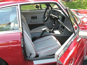

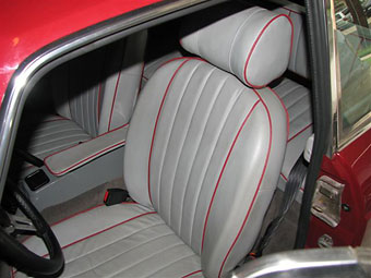

Interior: new gray leather upholstery (from "Prestige Leather"), custom gray dashboard trim, radio console, and center console. Mountney leather-wrapped steering wheel. Stainless shifter knob. New carpet. New fabric headliner.

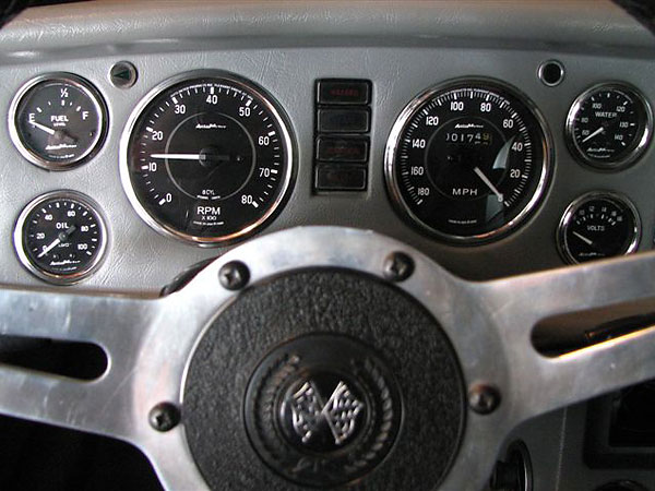

Electrical: Autometer "Cobra" gauges. Vintage Air air conditioning system.
Completed: June 2008. 300 miles driven.
Comments: this car was originally built to spec for Marc Kuritz.
RV8 headers
vented rotors and Wilwood calipers

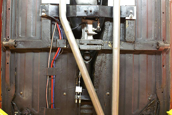

emergency brake cables
Autometer Cobra gauges
gray interior   Prestige Leather gray leather seat upholstery
engine compartment mods   boot

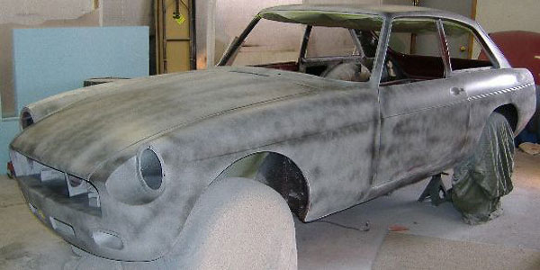

primer

MGB front suspension
vented and crossdrilled rotors
RV8 style headers
heat shields
exhaust pipes
rear suspension
Magnaflow muffler
anti-tramp bars

Sebring front valance
