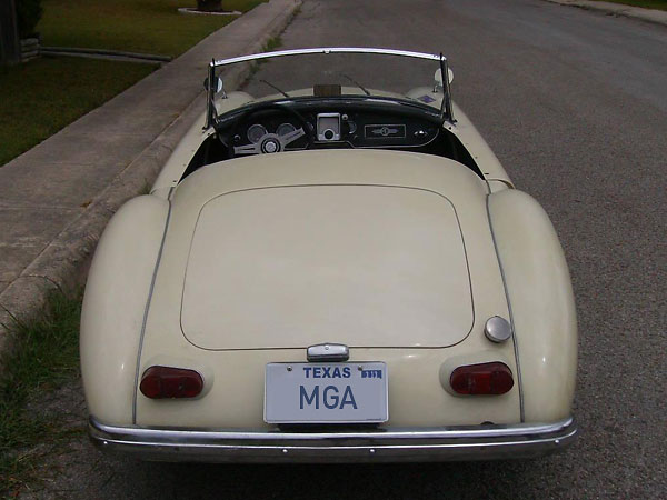

Darian Henderson's 1962 MGA MkII with Nissan CA18DET Turbo

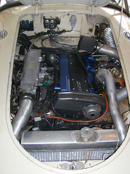

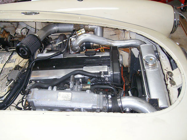

Engine: Intercooled Nissan CA18DET (16 valve, DOHC). This is a Japanese Domestic Market ("JDM") engine that came out of a Nissan Silvia (S13). Although Nissan didn't use the CA18DET engine in the U.S., a non-turbo version was used in the 1990 Nissan Pulsar, so most parts are readily available and affordable. There's also a large "tuner" scene for the CA18DET - with modifications these engines can be tuned to produce up to 600hp! - so you can find many performance parts. At a stock turbo boost level of 6 lbs, the engine is rated at 173 hp (124 kW) and 166 lb·ft (228 Nm) of torque. Stock redline is rated at 7,200 rpm. However, you can safely push the engine much further if you remove the rev limiter. I'm currently running 10 lbs of boost.
Cooling: aftermarket 1965 Ford Mustang aluminum radiator.

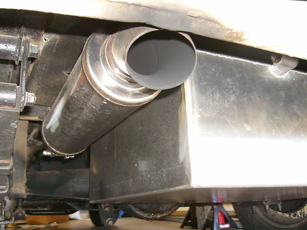

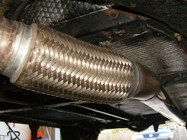

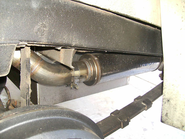

Exhaust: 2.5" custom engineered by Todd Budde. Magnaflow muffler.

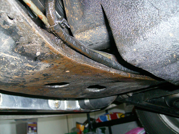

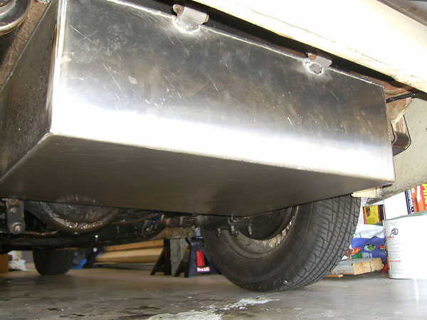

Chassis: The CA18DET is a front-sump engine, so the front crossmember had to be notched to clear the sump. The MG transmission mounts were cut off to allow the new transmission to be mounted. Todd Budde made the custom aluminum fuel tank. It's about the same size as the original, except square and with provisions for fuel injection. The passenger-side battery box was modified to accept an Optima battery.

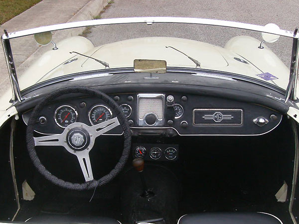

Electrical: stock CA18DET electrical system, with an alternator from a Nissan Maxima. New wiring harness with modern fuses. TPI Instruments gauges except for the boost gauge. I kept the Jaeger dual oil pressure / coolant temperature gauge.
Completed: July 2008. (Approximately 800 miles driven as of October 2008.)
Performance: I estimate that I have about 165-175 hp at the rear wheels. The car is fast! Below 3,800 RPM, the engine has 8 valves open and it drives like a stock MGA. At 3,800 RPM the turbo kicks in and 8 more valves start working. At this point you feel like you're getting hit in the back with a board and the next thing you know you're at 7,500 RPM. I don't race my car, but I love to accelerate. I especially enjoy popping the clutch into second gear from first when the turbo is spooled up. This car is the most fun between 20-75 MPH. Any more than that and you start feeling the limits of the stock MG suspension and steering.
Aftermarket 1965 Ford Mustang aluminum radiator.
A custom oil pan was also fabricated for the installation.
Braided stainless steel flex coupling for the exhaust.
Custom engineered 2.5-inch exhaust system, by Custom Rod Works
Custom engineered 2.5" exhaust system, by Custom Rod Works.
Magnaflow muffler.
Magnaflow muffler.
Custom Rod Works aluminum fuel tank
Custom Rod Works aluminum fuel tank.

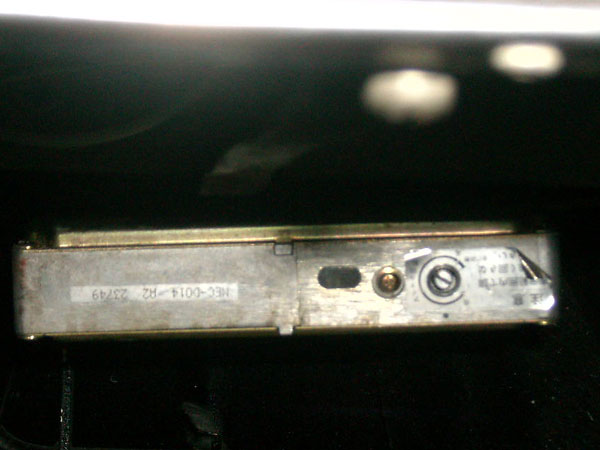

CA18DET engine ECU
The engine ECU is mounted under the passenger side of the dashboard.
TPI Instruments, boost gauge, and Jaeger dual oil-pressure/coolant-temperature gauge
"TPI Instruments" gauges except for boost gauge and Jaeger oil-pressure/coolant-temperature gauge.

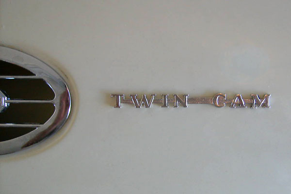

MGA Twin Cam badge
Truth in advertising! The Nissan CA18DET is after all a "Twin Cam" engine.
