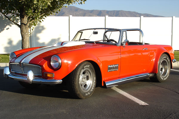

Model: 1964 MGB
Engine: Ford 289 V8
Conversion by:

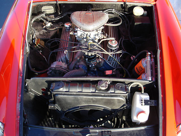

Engine: Ford 289 V8 with 4-barrel Edelbrock intake manifold and carburetor. Mallory ignition, cap and rotor.
Cooling: Ford Mustang/Falcon radiator, with electric fan.
Exhaust: custom headers to side pipes.
Transmission: 4 speed manual.
Rear Axle: not sure...
Front Susp.: stock.
Rear Susp.: stock.
Brakes: updated to a later-model MGB (dual circuit) brake system.
Wheels/Tires: aluminum slots.

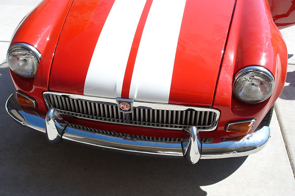

Body: fiberglass fender flares (front and rear). Fiberglass hood scoop.

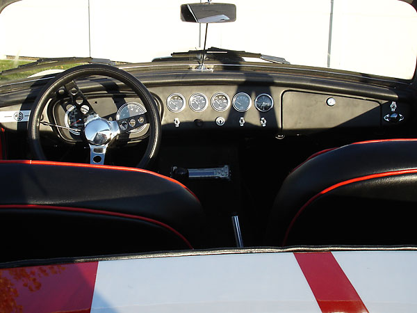

Interior: New Equuis gauges, Painless Wiring "T-bucket" wiring harness.

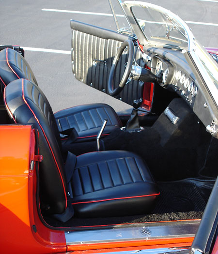

Comments: I purchased this conversion complete in June 2008. It was in rough shape, but I've made many mechanical and cosmetic improvements (completed in September 2008.) These include: removing the engine/transmission and replacing a stripped ring gear. Replacing the starter. Painting the exterior. Rewiring the car. Completely re-doing the interior carpets and upholstery. Installing new gauges. Replacing the hood and latches. (It previously had an MGC-replica hood with a forward-facing hood scoop.) Replacing the grille and badges. Installing a new radio and speakers. Chrome plating the roll hoop. Installing chrome covers over the mufflers. Etc.
