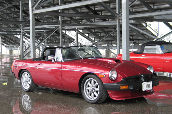

Bill Yobi's 1979 MGB with 1962 Olds 215

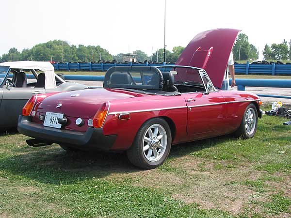

Bill Yobis 79 MGB with Oldsmobile 215 V8
with 1962 Oldsmobile 215
(originally shown in MG V8 Newsletter, Volume 8 Issue 3)

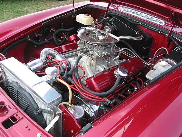

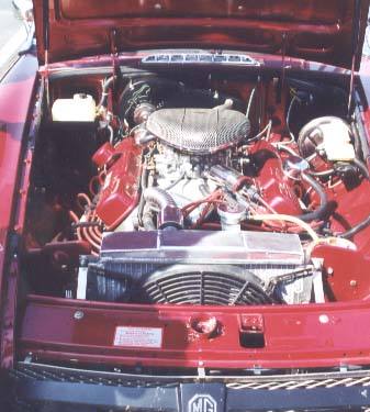

ENGINE:   4-barrel heads (10.75:1 version), TRW forged pistons (actual measured compression ratio of 10.4:1), larger valves/ported head, Isky 272 cam, balanced, Carter 500cfm (stock manifold), MSD 6AL capacitive discharge ignition system, baffled oil pan, oil cooler w/ thermostat
COOLING:   B-Cool aluminum radiator, Spal fan, CoolFlex corrugated metal radiator hoses

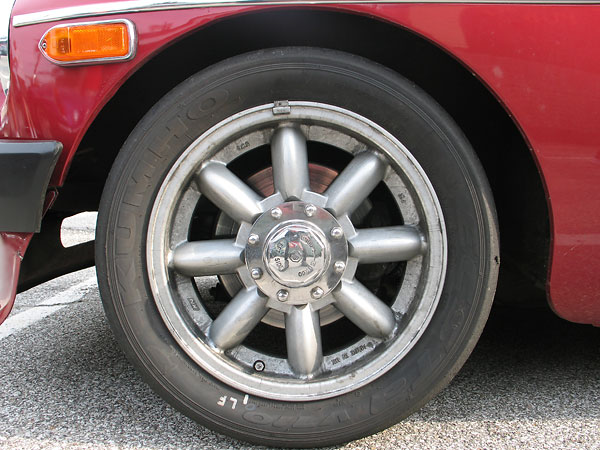

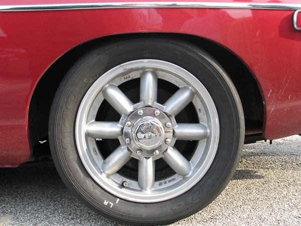

WHEELS/TIRES:   15 X 5.5 Minilite replicas (knock-offs), Bridgestone RE71 195/60
EXHAUST:   stainless steel block hugger headers, custom dual exhaust, Turbo Flow mufflers, Monza resonator tips

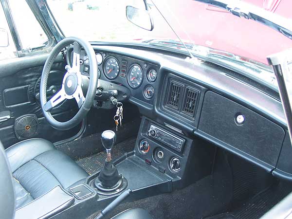

INSTRUMENTS:   stock and VDO

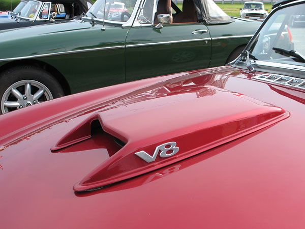

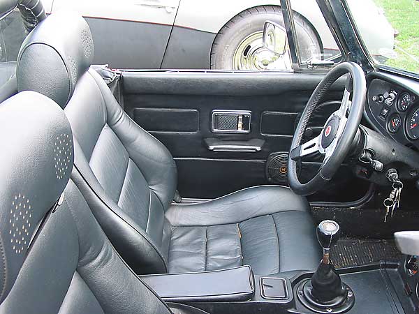

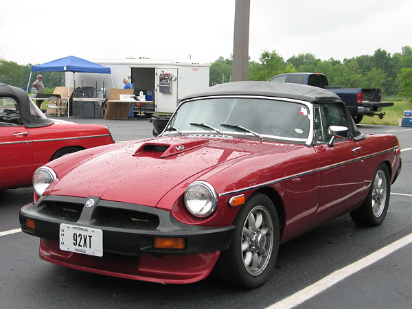

SPECIAL FEATURES:   paint (candy apple red metallic), Fiero leather seats w/ speakers, back seat for kids, functional hood scoop, gas struts hood and trunk

Oldsmobile aluminum v8
leather wrapped steering wheel
leather upholstered Fiero seats

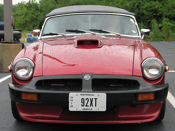

rubber bumper
fiberglass ST air dam
hood scoop
windblocker
Minator knock-off wheels
Kumho tires
