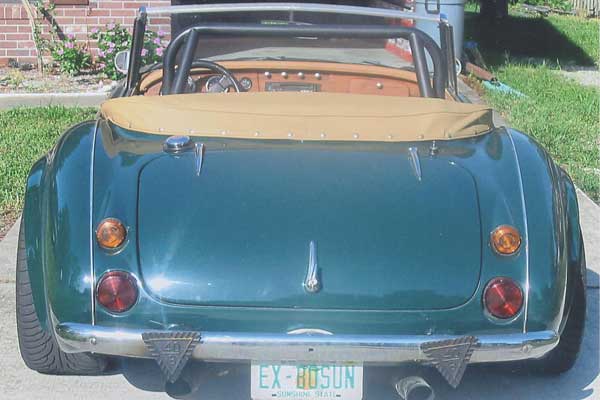

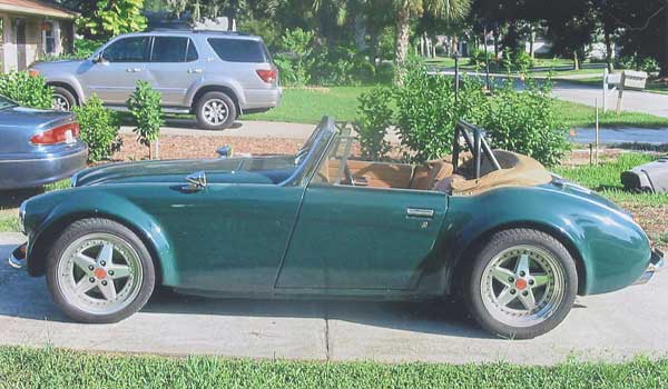

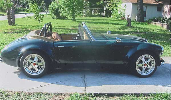

Owner: Mark Heller
City: Edgewater, FL

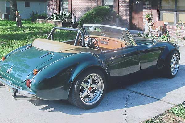

Model: 1961 Austin Healey 3000

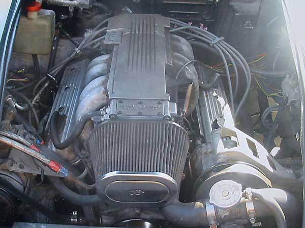

Engine: Chevy L98 5.7L (pushrod 16-valve) V8
VIN#: HBT7L5538.
Transmission: Borg-Warner T56 6 speed.
Differential: Dana limited slip.
Suspension: Corvette, including (narrowed, transverse leaf-spring) IRS.
Wheels: Corvette (17").
Curb weight: about 2200lbs.

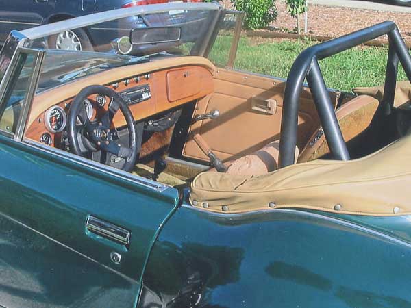

Other: Stereo radio, roll-hoop, roll-up side windows.
Comments : This is not for the faint hearted. It turns in the high 12's for the quarter mile, and the top end is tremendous. I chickened out and almost puked at 170mph with more to go!

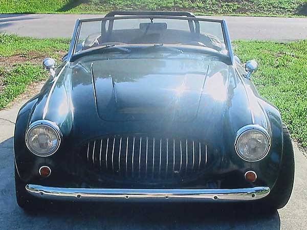

Mark Heller's 1961 Austin Healey 3000
Corvette L98 Engine
1961 Austin Healey 3000 - grille and hood
1961 Austin Healey 3000 - dash and steering wheel
1961 Austin Healey 3000 - rollbar and dashboard
