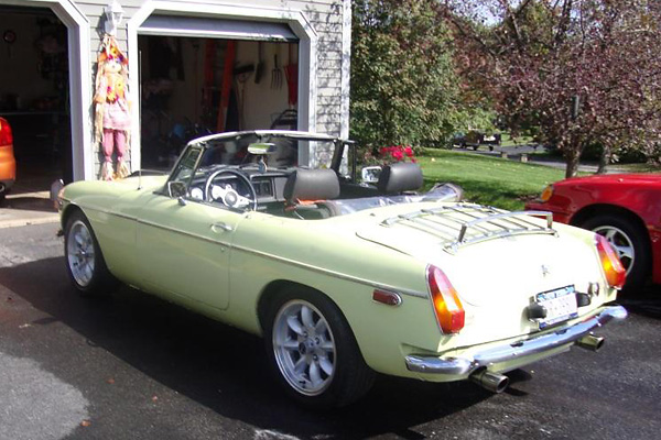

Steve LaGoy's 1977 MGB with Ford 302 V8 and Electronic Fuel Injection.
Steve LaGoy's 1977 MGB with Ford 302 V8 and EFI
Owner: Steve LaGoy
BritishV8 UserID: 77mgbv8
City: Baldwinsville (Syracuse), New York
Model: 1977 MGB
Engine: Ford 302 V8
Conversion by: owner

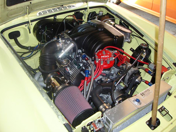

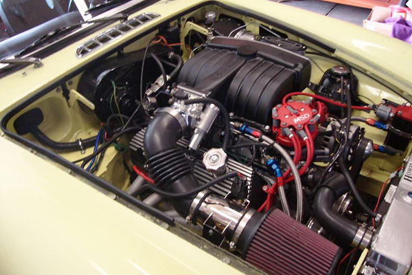

Engine: Ford Motorsport crate 302. Air Flow Research (AFR) model 165 aluminum cylinder heads. Ed Curtis custom ground camshaft. Comp Cam "Gold" roller rockers. Manley pushrods. Edelbrock Performer intake manifold. AccuFab 70mm throttle body. Pro-M 75mm Bullet MAF sensor. Detail Zone complete, self-contained EFI wiring harness (with its own fuse panel and relays). SCT switch chip (4 programs). All new sensors. 24lb fuel injectors. BBK fuel pressure regulator. Custom Rod Works aluminum MGB fuel tank with internal fuel pump. Aluminum / Russell stainless steel braided fuel lines / hose ends. MSD Pro-Billet electronic distributor and matching coil. MSD 8.5mm spark plug wires. Canton billet aluminum remote oil filter mount. Ford Racing FI aluminum valve covers.
Cooling: Howe Racing custom aluminum radiator. SPAL 2350cfm electric fan. Permacool adjustable fan controller and relay. Flow Kooler hi-performance waterpump.

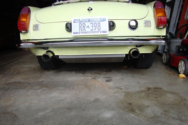

Exhaust: Coyote Racing exhaust headers with Jet-Hot ceramic coating added. Custom dual 2.5" bore exhaust featuring a Magnaflow X-pipe and dual Magnaflow Mufflers plus Classic chambered exhaust pipes. Resonator mufflers. All constructed with T409 stainless steel.

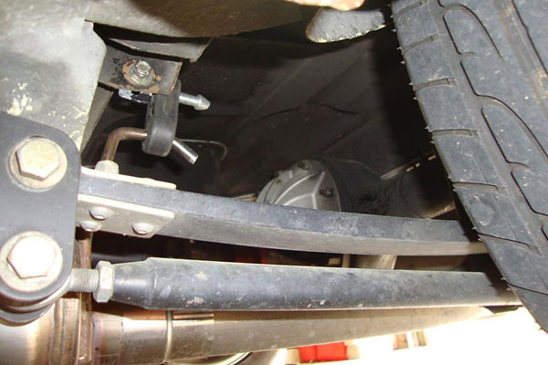

Rear Susp.: British Automotive composite leafsprings. KBY telescoping shock absorbers. British Automotive traction bars and Panhard rod.

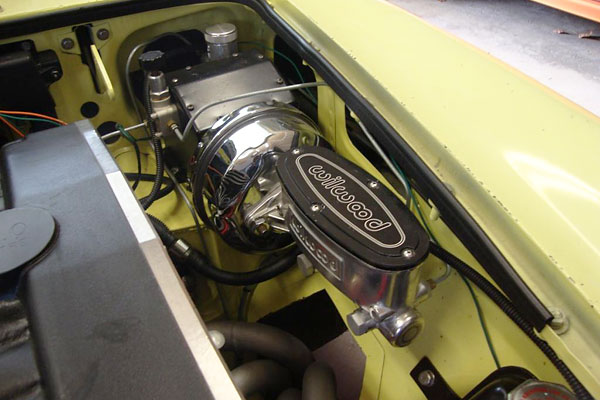

Brakes: (master) Wilwood tandem cylinder. Tuff Stuff chrome single diaphragm booster. Wilwood proportioning valve.

Body: converted to chrome bumpers.
Weight: ~2250lbs.
Completed: the original Rover V8 conversion was completed in 2002. The car has gone through several iterations now to what you see here. All told, ~25,000 miles.
Comments: besides being an extremely quick car, I'm especially pleased with braking set-up. The car will stop on a dime and I'm very hard pressed to get any brake fade after repeated stops.
Ed Curtis, my camshaft grinder, claims I should see 325-350hp at the rear wheels. That's yet to be proven, and it's a bit optimistic in my opinion. Based on my G-Tech, the MGB consistently runs mid 5 second 0-60mph times. Obviously the biggest issue is rear tire hook-up, but the Dunlops are pretty sticky!
The body is 99.9% rust free, but needs new paint. I have procured a Morspeed fiberglass MGC-style hood skin, modified with raised rear for fuel injection, which I plan to install. I also have a set of Pontiac Fiero seats in great condition that I hope to eventually reupholster and install.

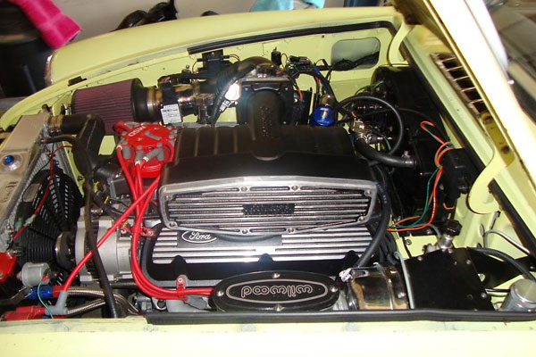

Ford Motorsport crate 302 with AFR 165 aluminum cylinder heads and custom Ed Curtis camshaft.

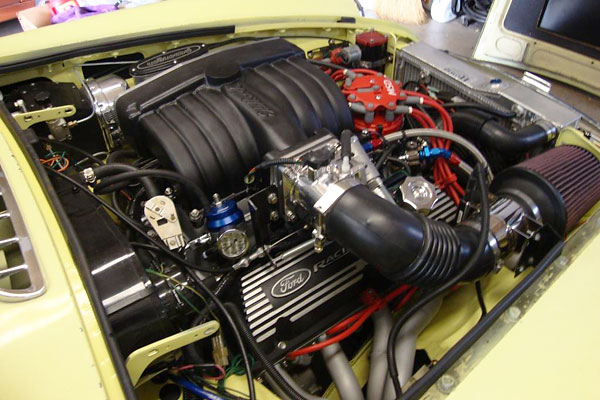

A BBK fuel pressure regulator serves fuel to the 24lb fuel injectors.

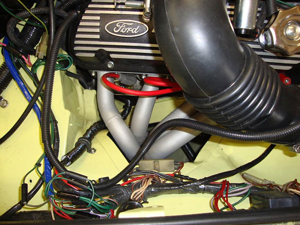

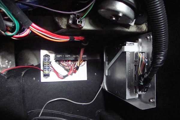

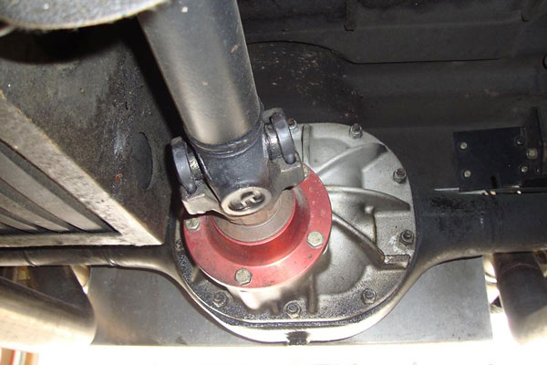

Rear Axle and Suspension
Fast Cars narrowed Ford 8 inch axle. Aluminum differential carrier. Auburn limited slip differential.
Fast Cars narrowed Ford 8" axle. Aluminum differential carrier. Auburn limited slip differential.
British Automotive composite leafsprings and traction bars.
