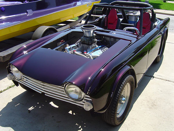

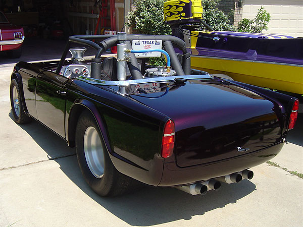

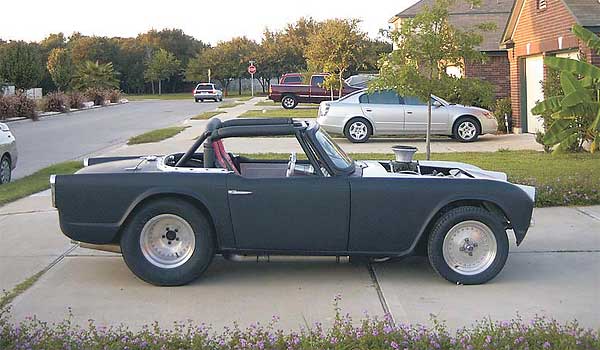

Owner: Jason Norman
Model: 1967 Triumph TR4

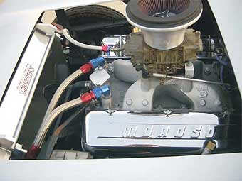

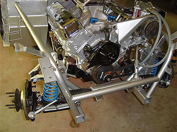

Engine: Engine: 1968 427 Chevy 0.100" over-bored (approximately 447cid). Roller cam.

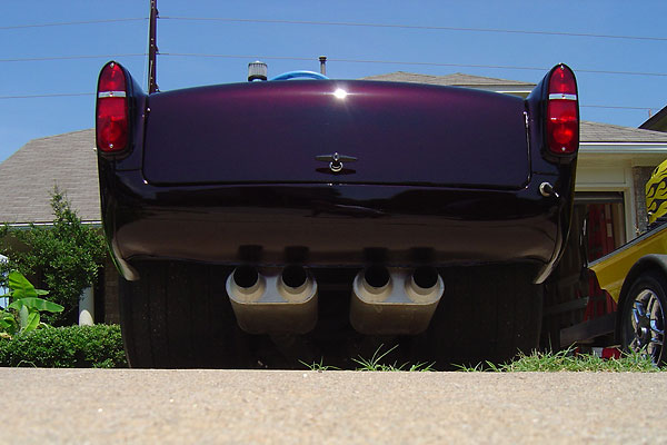

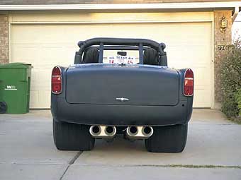

Exhaust: 4" collectors into 3.5" exhaust.
Transmission: Super T-10 4 speed, aluminum flywheel.
Rear axle: Ford 9" 31 spline, 4:11 Detroit Locker, 4-link rear suspension.

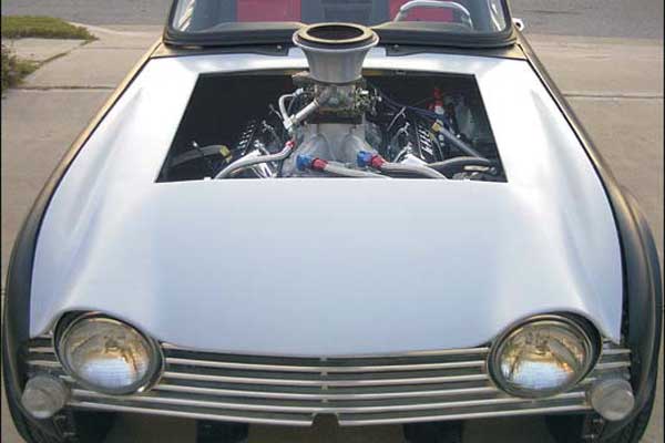

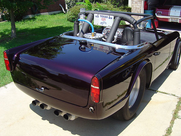

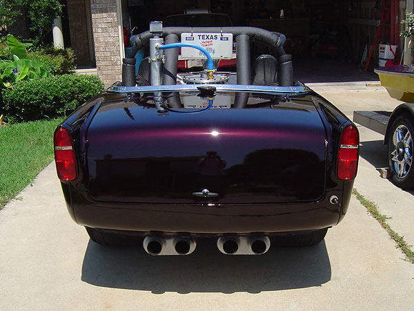

Comments: The motor has about 100 miles on it at this time. After the break-in period is over, I'm going to put an 1800cfm mechanical fuel injection on top, but for now I'm running a 750 Holley until the rings are seated.

Holley 750 carb with velocity stack     1967 TR4 viewed from the rear

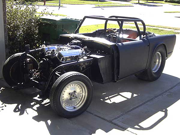

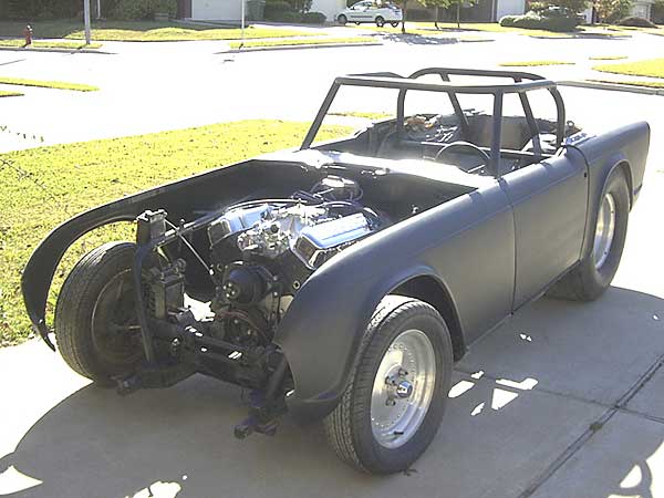

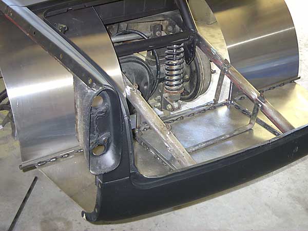

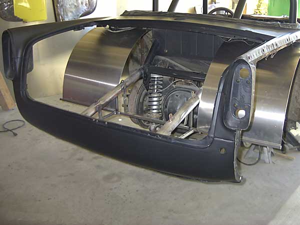

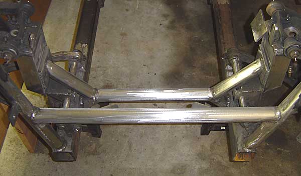

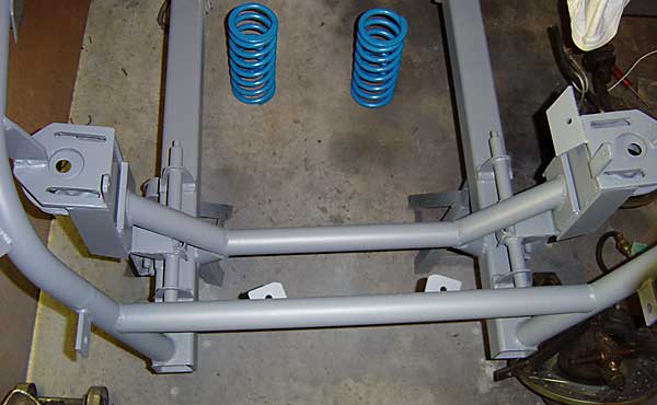

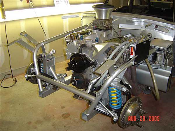

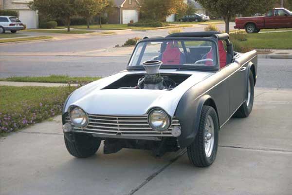

(In the additional photos I've sent...) I tried to show a progression from when I started until recent changes. I'm sure you can see the progression. This thing was garbage when I got it: full of Bondo, chicken wire, newspaper stuffed into rust holes and mudded over. The frame was twisted 2 1/2" from front to back. I got it with no drivetrain in it - but it had the narrowed rearend. The rest was absolute junk. I mean wiring, sheetmetal, frame, interior, brakes, suspension and everything - all absolute junk! I should have just took the rearend out and crushed the car, but I loved that it was a '67 TR4, and I was putting a '67 427 chevy together on the engine stand when I got it - so here we are.

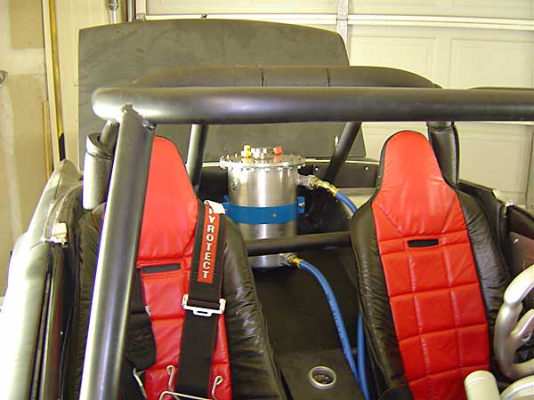

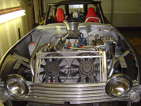

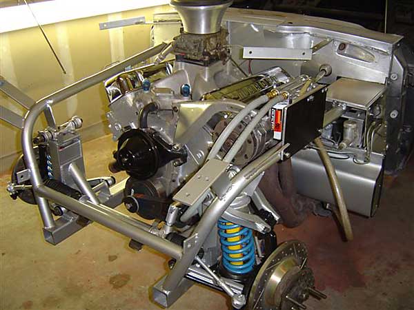

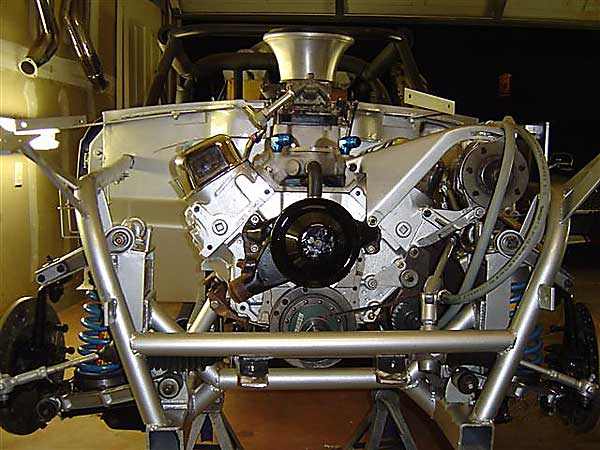

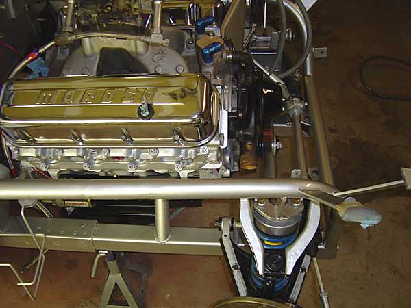

The engine I have in it now is the same 0.100" over 427 (1967) that I had in it the first time I sub'd to your site, but I tore it down again when I did the frame, suspension, firewall modifications and all the new fabrications. I put in chrome-moly H-beam rods, a 4-bolt main stud kit, and I studded the heads as well. I installed a 4-stage dry sump 3.5 gallon oiling system too.
improving a Triumph front end
fabricating a new front suspension
custom chassis and suspension
custom chassis fabrication
custom Triumph TR4 independent front suspension
custom TR4 racing suspension
custom TR4 racing frame

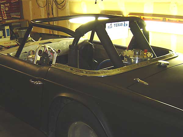

Pyrotech racing harnesses
Racecar cockpit

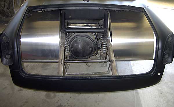

Triumph TR4 rear frame extension
Narrowed Triumph rearend
Rear tubs

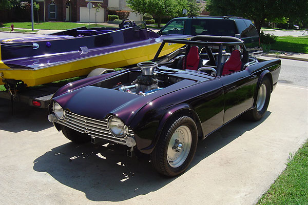

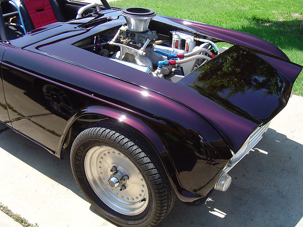

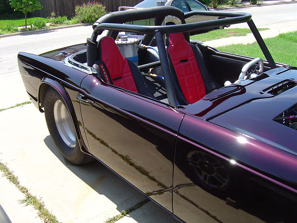

The paint is a 3 stage homemade color
Note: The paint is a 3 stage homemade color consisting of: charcoal base coat, pure color dye coat, and urethane clear coat.
charcoal base coat
pure color dye coat
urethane clear coat
