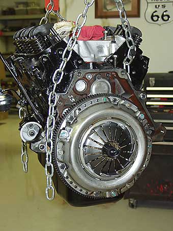

Model: 1964 MGB

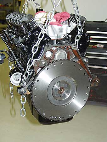

Engine: GM 3.4L crate 60-degree V6

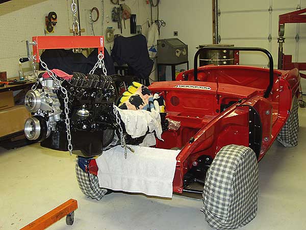

| Installation: | Classic Conversions Engineering (Bill Guzman, proprietor) engine and transmission
mounts were used. The ignition system and electronics are all "standard" to the GM engine. |

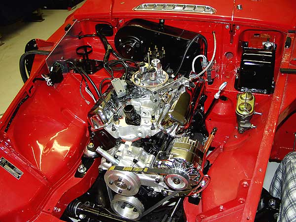

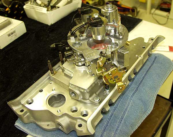

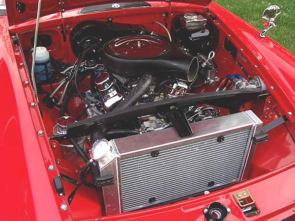

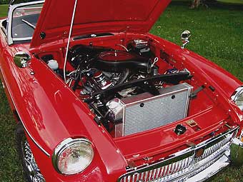

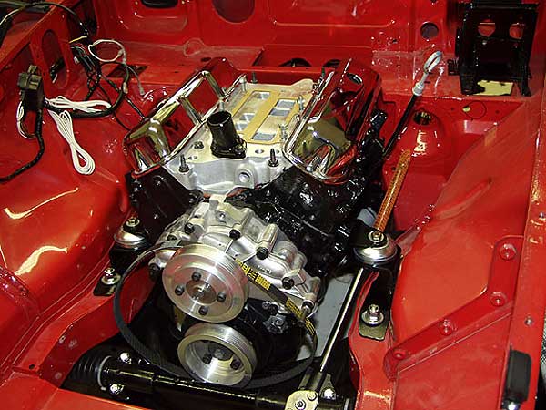

| Intake: | Edelbrock manifold with the top-half milled down. Holley 950 Commander throttle-body
fuel injection system. (I'm quite pleased with the programmability, performance and
responsiveness of the unit! Plug in a laptop and parameters are quite easy to change.) |

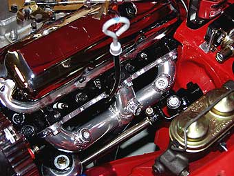

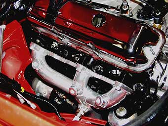

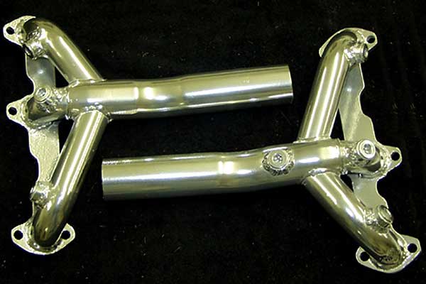

| Exhaust: | Headers from Classic Conversions Engineering (Bill Guzman, proprietor).
(I welded-on sensor bungs and had them Jet-Hot coated.) The mufflers are
Flowmaster Super-40's, with 2.5" inlet and outlet ports. |
| Cooling: | The radiator was custom-built by "Performance Rod and Custom" (aka: PRC):
"You give them dimensions and the location of everything such as cap, input, output,
and drain..." The fan is controlled by a thermostatic switch, with an override switch
on the dash for redundancy. The aluminum radiator overflow tank was fabricated by owner. |

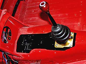

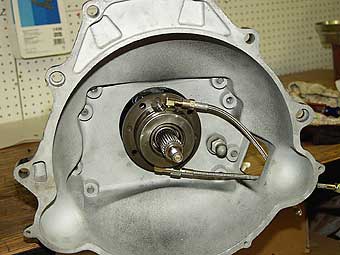

| Transmission: | Camaro T5 5-speed. McLeod hydraulic throw out bearing. Wilwood clutch master cylinder, with
owner-fabricated aluminum reservoir (which was required for hood clearance.) |

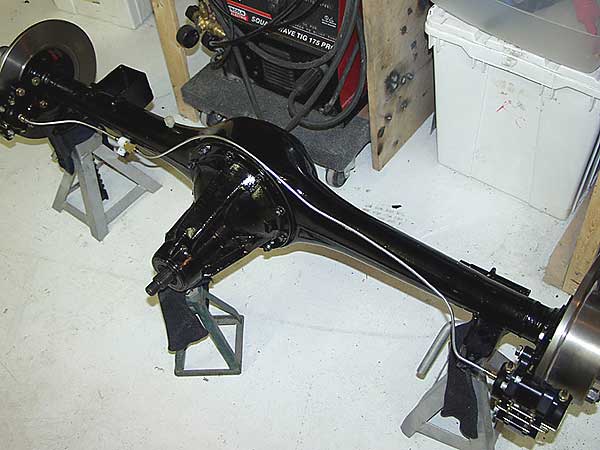

| Rear Axle: | Stock MGB (early "banjo" type) except the axle shafts and splines were replaced with new. |

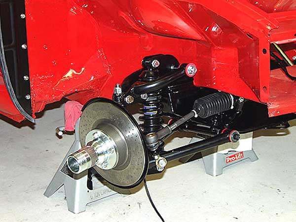

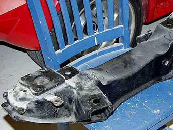

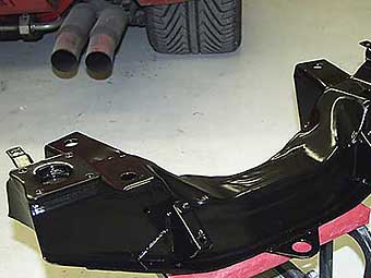

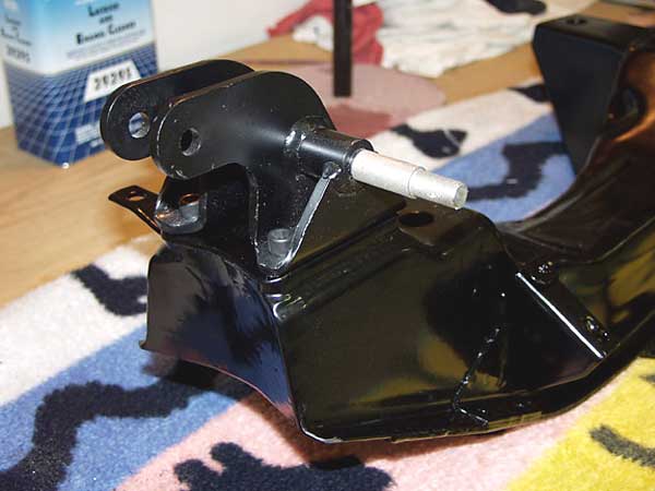

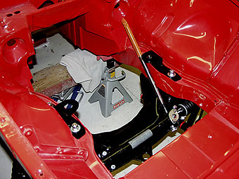

| Front Susp.: | Hawk front suspension (with coil-over shocks on a modified MGB front crossmember.
Rebuilt MGB kingpins and new splines for knock-off wheels.) Up-rated anti-sway bar. |

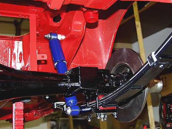

| Rear Susp.: | Disassembled and rebuilt leaf springs. Polyurethane bushings. Telescoping shock absorbers.
Up-rated anti-sway bar. Panhard rod fabricated from scratch. |

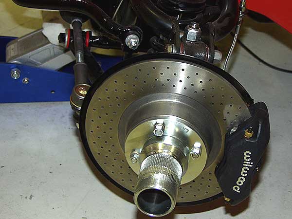

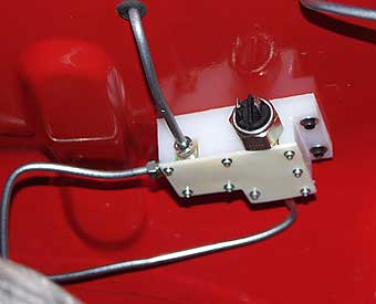

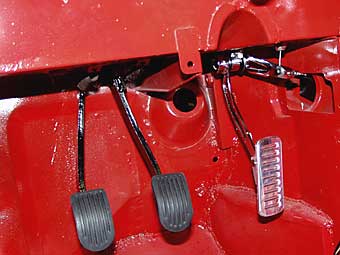

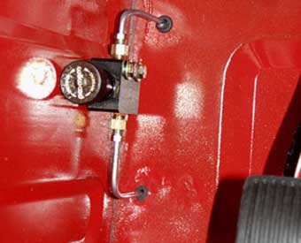

| Brakes: | Wilwood 1" dual-line master cylinder located on the firewall and attaching to the pedal
below its pivot, as shown in the photos. (1" was the smallest aftermarket cylinder

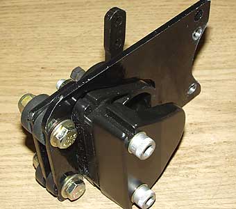

available.) "Whoa" brand front disk brake kit with Wilwood calipers.

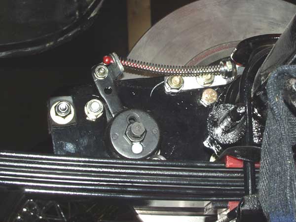

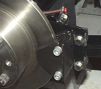

Rear disk brake conversion with Wilwood calipers, rotors, and secondary cable-actuated
parking-brake calipers. All brake lines are double-flared (i.e. no bubble flares). "My
goal was to be able to find all connectors and parts either locally or through standard
hot-rod distributors. I try to stay away from oddball things. |

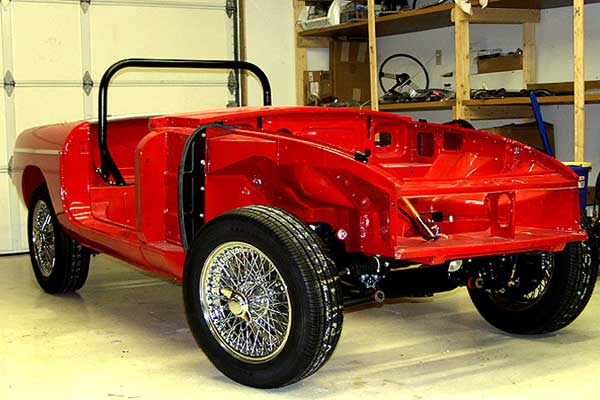

| Wheels/Tires: | New 15-inch 72-spoke wheels with Uniroyal 196/65R15 tires. |

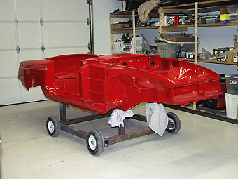

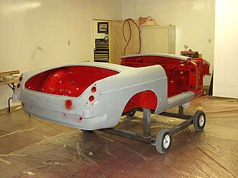

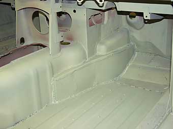

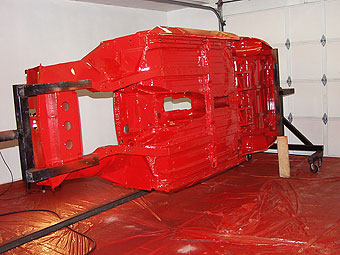

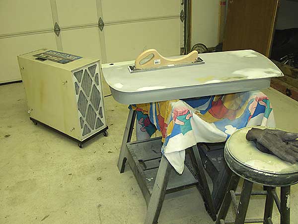

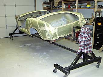

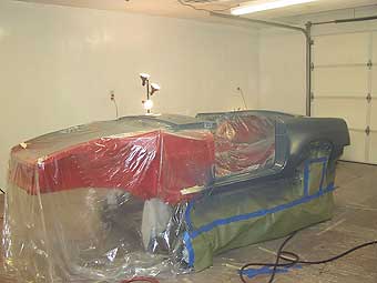

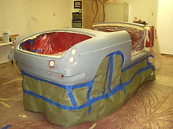

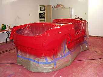

| Body/interior: | This was a nut and bolt bare-metal rotisserie restoration! Car was stripped to the frame and
everything cleaned, rebuilt, repainted or replaced. Paint in Dupont 2-stage base-coat/clear-coat.
(The color is from their "pure red" chart, and is very similar to "Viper" red.) Everything from
bumper to bumper was reconditioned or replaced. All chrome is either new or re-chromed. Many

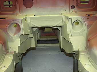

changes and updates which include 1999 Toyota truck window regulators. Since an early-model MGB
was used, significant modifications to the transmission tunnel were required. |

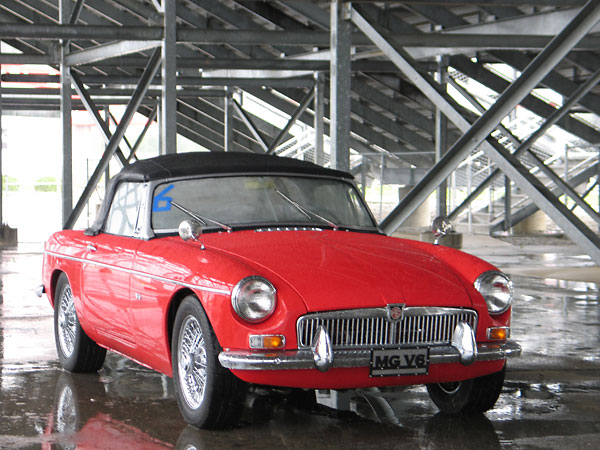

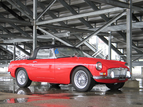

| Completed: | Ran for the first time on May 29, 2006 - but the project is continuing! |

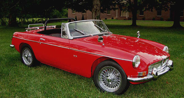

| Comments: | The goal of this project was to make the car pretty much stock-looking externally yet modern
in drivability and operation. I think the car does this well. From the fuel injection to
the Toyota window regulators, the car is solid and trouble free! |
The Hawk Cars coil-over front suspension was developed by Hoyle Engineering Ltd.
Whoa Brakes front brake kit with Wilwood Dynalite forged calipers.
Cable-operated secondary rear disk brake calipers for parking.
Headers from Classic Conversion Eng., but with extra sensor bungs and Jet-Hot coating added.
Edelbrock manifold milled-down and fitted with Holley 950 Commander EFI.
Gary's MGB V6, as presented at BritishV8 2010
(The number "6" was temporarily assigned for scoring our autocross event.)
