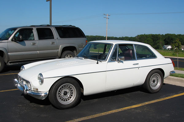

Bruce Wyckoff's 1974.5 MGB, with Buick 215cid V8
Bruce Wyckoff's 1974.5 MGB with Buick 215cid V8, by Fast Cars Inc.
(originally published in British V8 Newsletter, Volume 10 Issue 1)
Owner: Bruce & Connie Wyckoff
City: Kennesaw, GA
Model: 1974 1/2 MGBGT
Engine: Buick 215
Conversion performed by: Fast Cars, Inc.

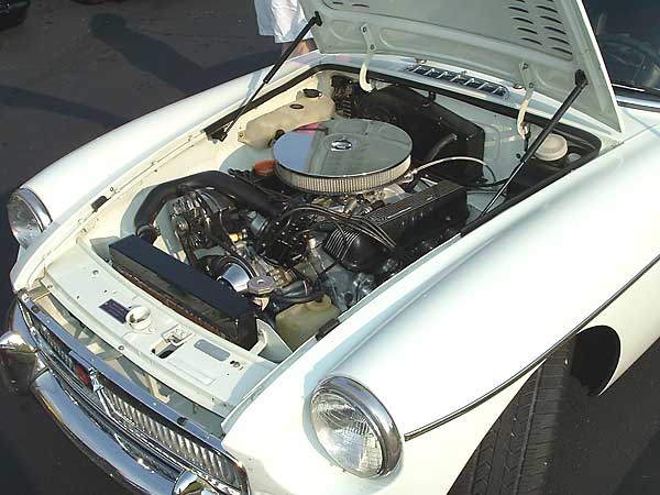

Engine: 1962 Buick 215ci aluminum V8, with a Crane cam (duration of 214 degrees intake, 218 degrees exhaust, at 0.050" lift, maximum lift of 0.488", separation angle is 112 degrees). Intake system uses a 500cfm Edelbrock carb on a stock Buick manifold.
Exhaust: Block hugger headers from D&D Fabrications, with 1 5/8" diameter primary tubes.
Cooling: Brass downflow radiator from D&D Fabrications. Spal electric fan installed in a "puller" configuration. Stock water pump. To move the radiator forward enough to allow room for the puller fan, a notch was cut into the front lower body crossmember.
Transmission: Borg-Warner T5, with a McLeod hydraulic throw-out bearing. Bellhousing is stock Buick.

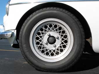

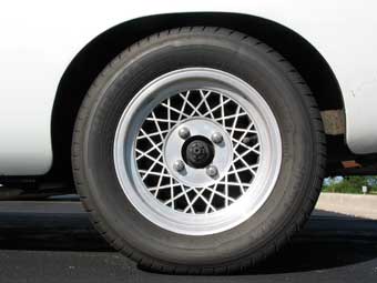

Wheels/Tires: Mirada Sport GTX 205/60/R14 tires on aluminum wheels.

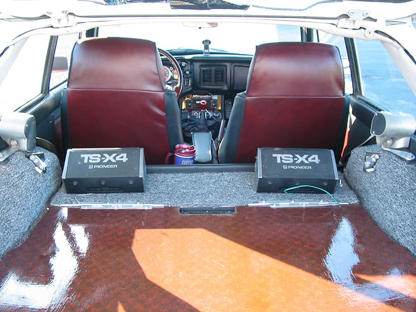

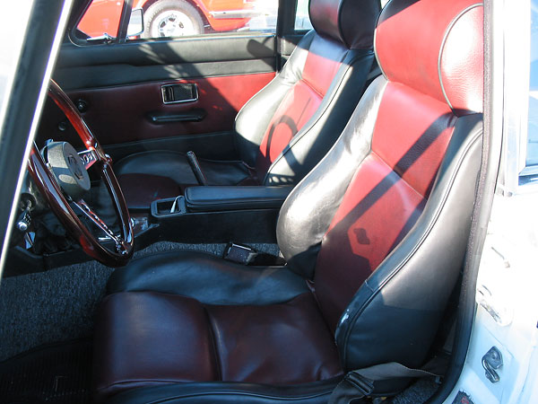

Interior: Pontiac Fiero seats. Custom upholstery, trim and carpet throughout.

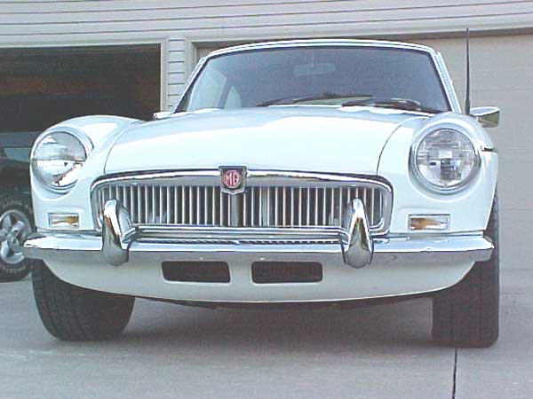

Both the stock and the conversion engine/transmissions were weighed, and the Buick/T5 weighed 50 pounds less than the stock MGB engine/transmission. Converting from rubber bumper to chrome bumper further reduced the total weight of the car. Ted Lathrop of Fast Cars, Inc. was great to work with on this conversion. His explanation of the conversion process was great. Ted supplied a complete step-by-step description of the process, and there were never any surprises.

1962 Buick 215ci aluminum V8 with Crane cam

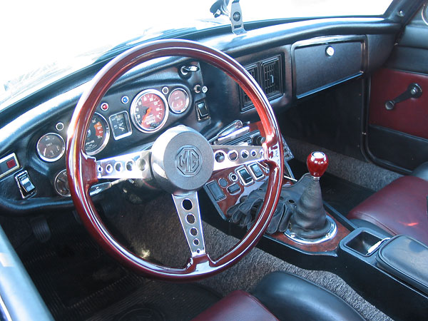

wood steering wheel
Pontiac Fiero seats
Pioneer TS-X4 speakers

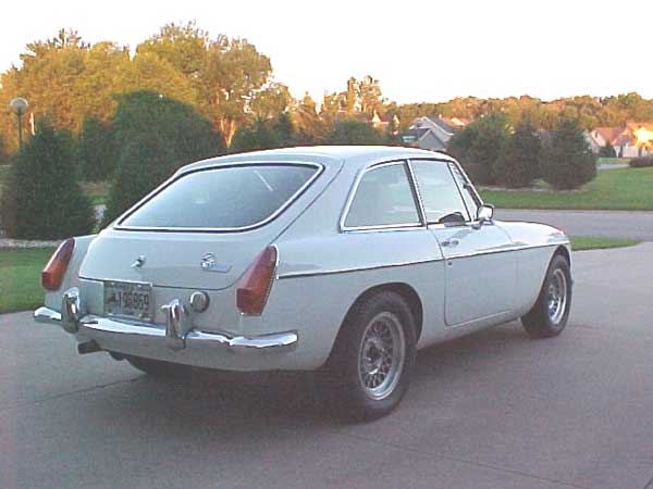

chrome bumper conversion
converted from rubber bumper to chrome bumper
Mirada Sport GTX 205/60/R14 tires   14 aluminum wheels
