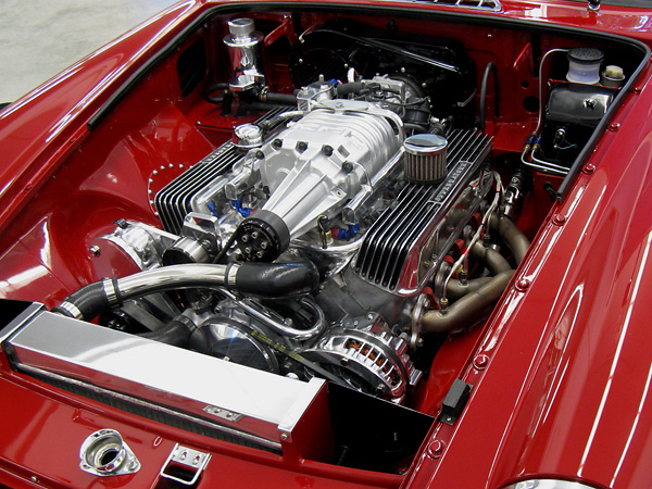

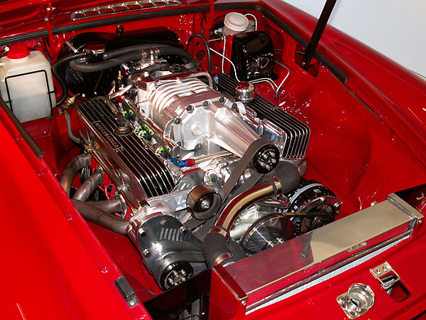

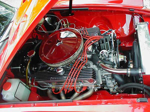

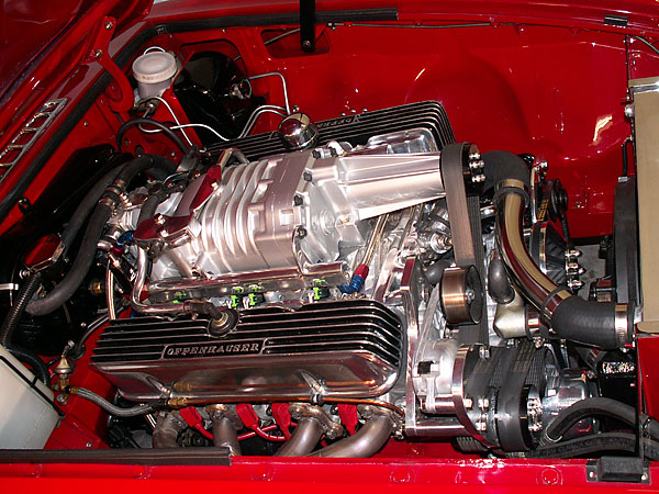

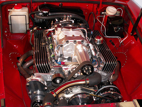

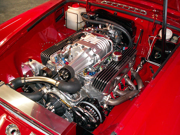

Bill updated his MGB in summer 2007 with a supercharger and fuel injection:
More detailed technical information and photos of the installation can be found here: Under-Hood Eaton M90 Supercharger.

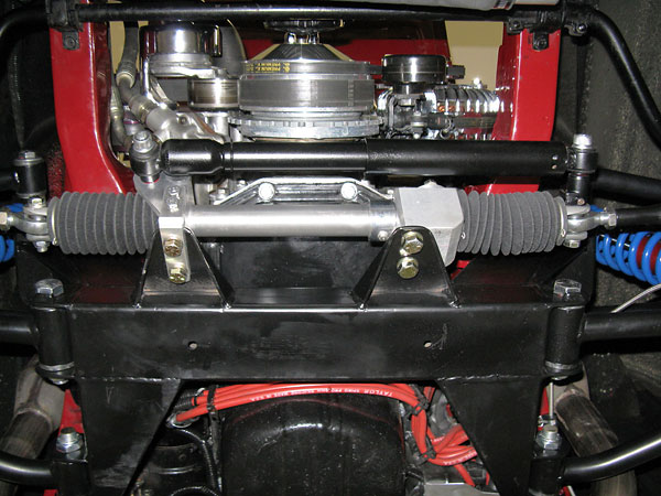

GM / Eaton M90 supercharger, off of a 96 Buick 3800 V6
Custom built intake manifold, made from T6061 aluminum flat stock. Cowl induction.
Custom fuel injection system, using GM Delphi fuel injectors
MegaSquirt II EFI controller, Ford EDIS ignition system

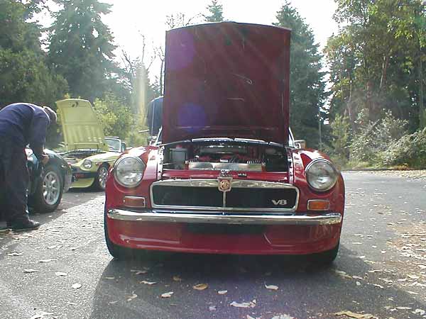

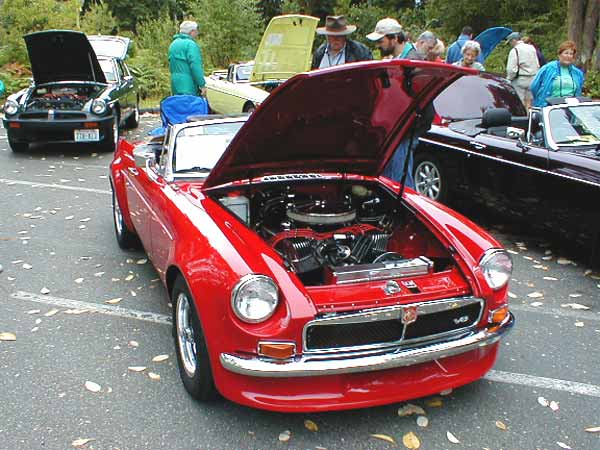

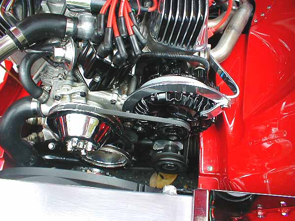

Bill Jacobson's Buick 215cid MGB V8

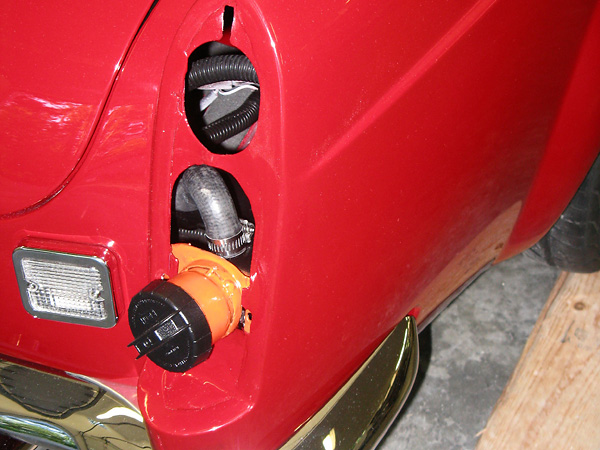

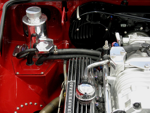

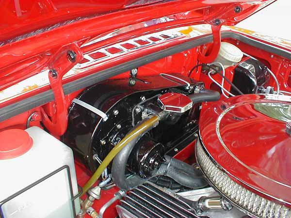

Coolant filler cap Buick 215cid MGB V8
Coolant filler cap

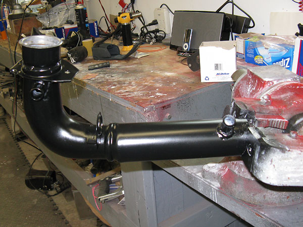

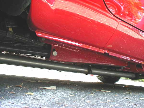

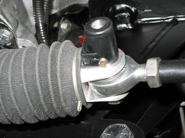

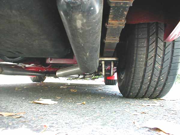

Custom traction links MGB V8

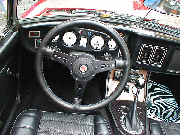

full whiteface VDO Gauges MGB V8
Driver's view - full whiteface VDO Gauges

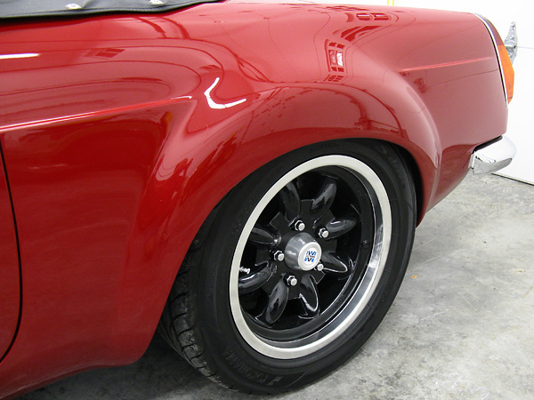

Bill Jacobson's Buick 215cid MGB V8     Datsun 510 Rear wheel flares MGB
Rear wheel flares were taken from a Datsun 510.

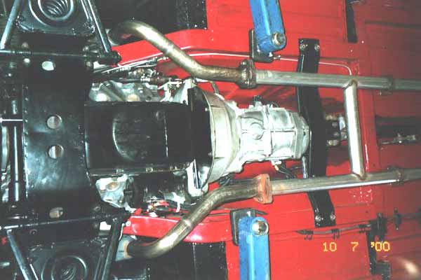

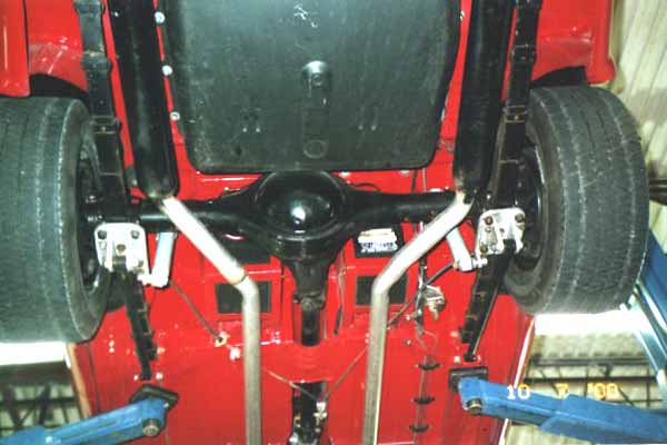

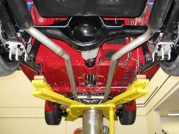

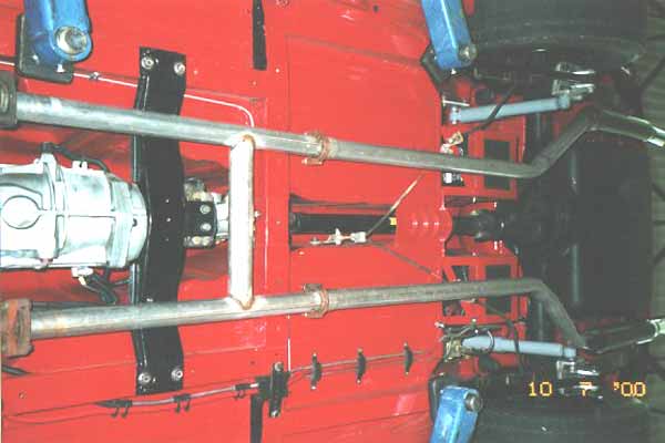

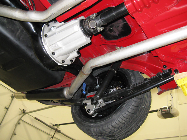

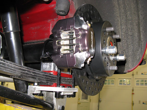

Chrysler rear MGB V8
Chrysler rear with 5 lug hubs (re-drilled to match MGC pattern)
